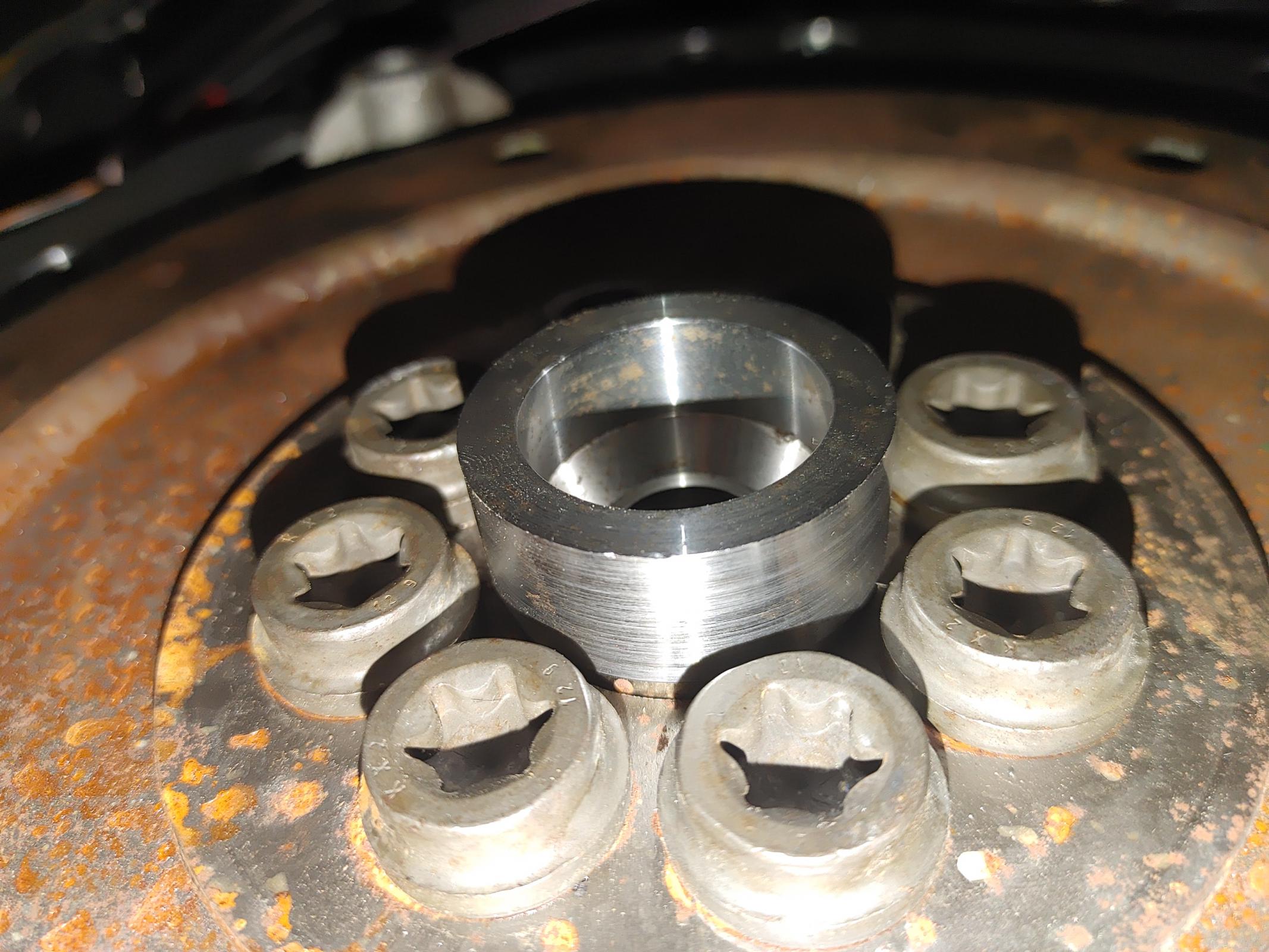

7. The shim fitting goes into the hole between the flywheel bolts. The added large bolt is just to remove fitting if needed. I needed to because i put some blue locktite in there as well.
Mine went in pretty easy. If its tight its suggested putting it in the freezer overnight. Put that in and tapped it in with a rubber mallet. Should be snug.
