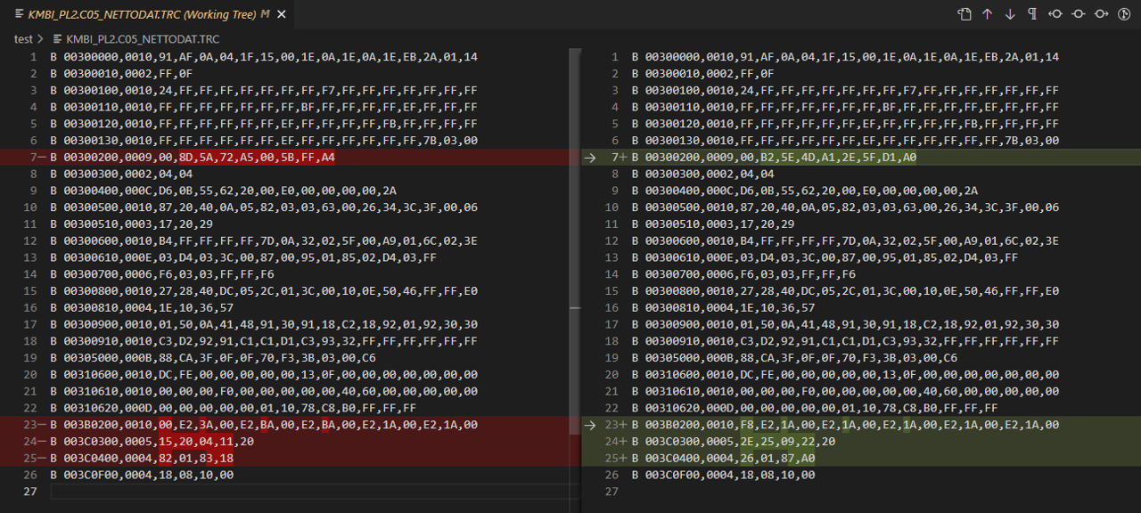

I also looked into the coding aspect of getting the speedometer and odometer to read correctly from smaller diameter wheels/tires and also went with this setup because rolling diameter is almost the exact same as non-M3 E9x 18" spec.
To code the speed/odo correction, it is in the KOMBI module.
I changed these stock parameters:
C08_K_ZAHL_TACHO
wert_03
C08_K_ZAHL_TACHO_KOMPL
wert_03
C08_K_ZAHL_WEG
wert_03
C08_K_ZAHL_WEG_KOMPL
wert_03
To what NCSDummy shows for E9x non-M3:
C08_K_ZAHL_TACHO
wert_02
wert_02
C08_K_ZAHL_WEG
wert_02
wert_02
I had originally used the Z4 (E89) settings of wert_07/wert_05 respectively until I noticed that Z4 uses different rear-wheel sensor; however, this part is the same for all E82/E92/E90 models.
I have tested using the digital, non-corrected, speedometer versus 3 "Your Speed IS" signs in my neighborhood to confirm and seems to be dead-on.
I also did a distance test of the odometer/trip-meter vs google maps distance, which also appears dead-on.
I had originally used the Z4 (E89) settings of wert_07/wert_05 respectively until I noticed that Z4 uses different rear-wheel sensor;however, this part is the same for all E8x/E9x models.
I also did a side-by-side comparison of the NETTODAT.TRC files from stock to after coding to Z4 (E89) spec. I can see that the proper values for Z4 were applied at the correct address; but it also looks like the lastWriteTime of the KOMBI module might be recorded in this module (as a checksum) and thus to write/code it, you may need to start from reading the KOMBI module's current coding and modifying from there. This kinda makes sense as it could be some sort of protection against odometer tampering.
I'd say this confirms my car's manufacturing date as April 20, 2011

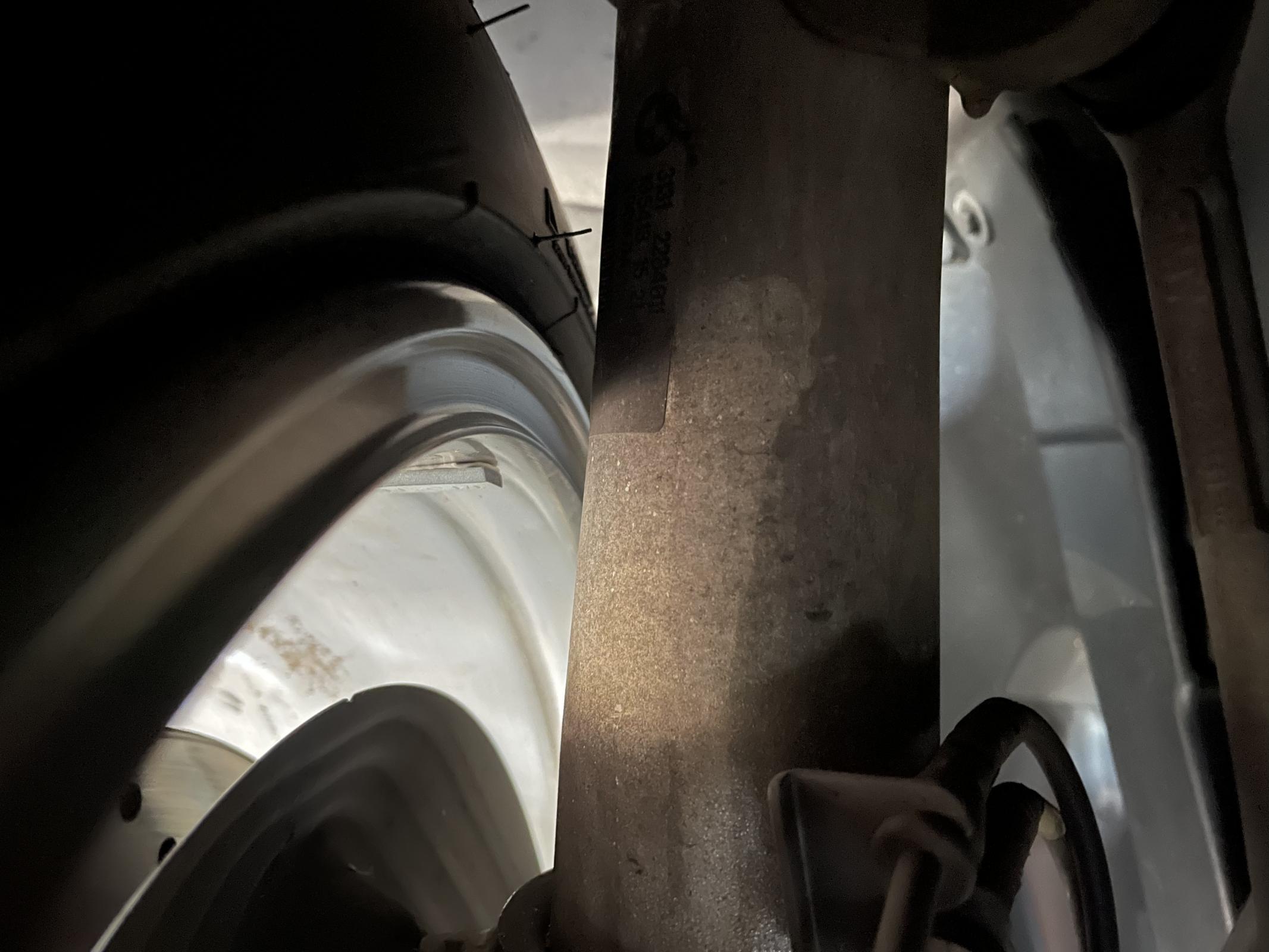

      09-27-2022, 04:24 PM   #10
PRTSB1M
374
504
Drives: AW3 1M
Join Date: Feb 2015
Location: Thunderdome
Originally Posted by Expert@ApexRaceParts View Post
How is the inner clearance to the front strut assembly? If I recall correctly that was our main concern.
This is definitely the tightest part of the fitment, as expected. I can barely stuff my finger (not a bear claw) between the 255/35/19 et31 setup, tightest on the shoulder of the tire to the spring perch/strut tube.
With the 265/35/18 et28, there is better clearance away from the spring perch, but only 3-4mm from strut tube (again, measured with my blind finger). I don't think you could fit a 275/35/18.
We may have to revise the guide!
If I can make one recommendation, this is my "1M GTS" spec

      10-16-2022, 01:04 PM   #12
PRTSB1M
374
504
Drives: AW3 1M
Join Date: Feb 2015
I was able to get the car on a drive-on lift today, for pictures of inner clearance. Looks better from this angle than I thought it would from reaching back there.
