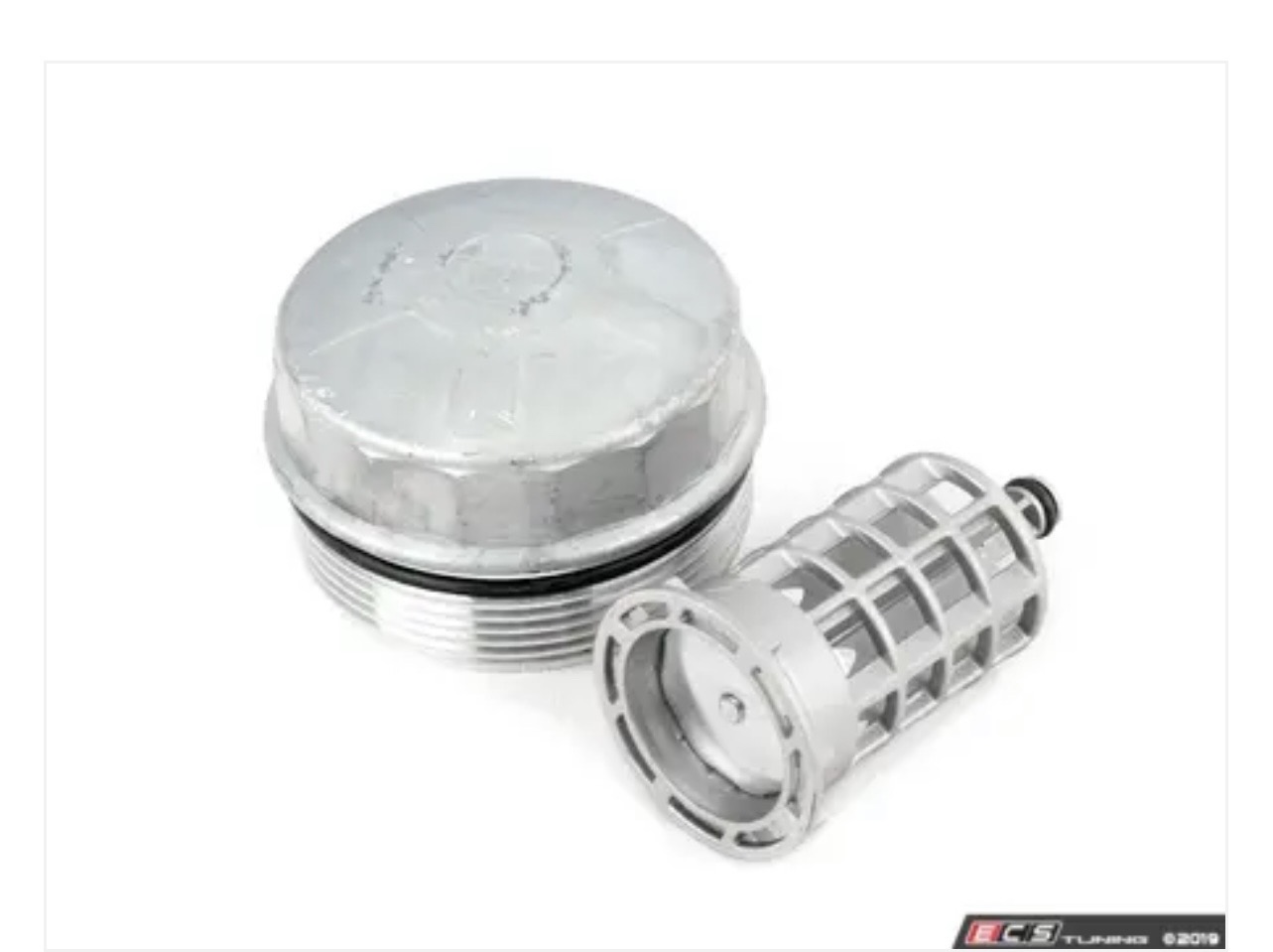

Did you accidentally throw out the cage in the oil filter cap ? This would cause vanos issues. Not sure that would cause misfires though.

      07-13-2023, 02:03 PM   #9
fast1eddy
fast1eddy's Avatar
324
400
Drives: 2008 135i Lemans Blue
Join Date: Jul 2013
Location: Edmonton
2008 135i  [0.00]
Originally Posted by andysantoro View Post
I don’t think I have a cage in my N54 OFH.
You should have a cage like this in your oil filter cap. Some people mistakenly throw it out with old filter.
Still have the cage in. At this point i think I’m tracing it down towards Intake VANOS solenoid
