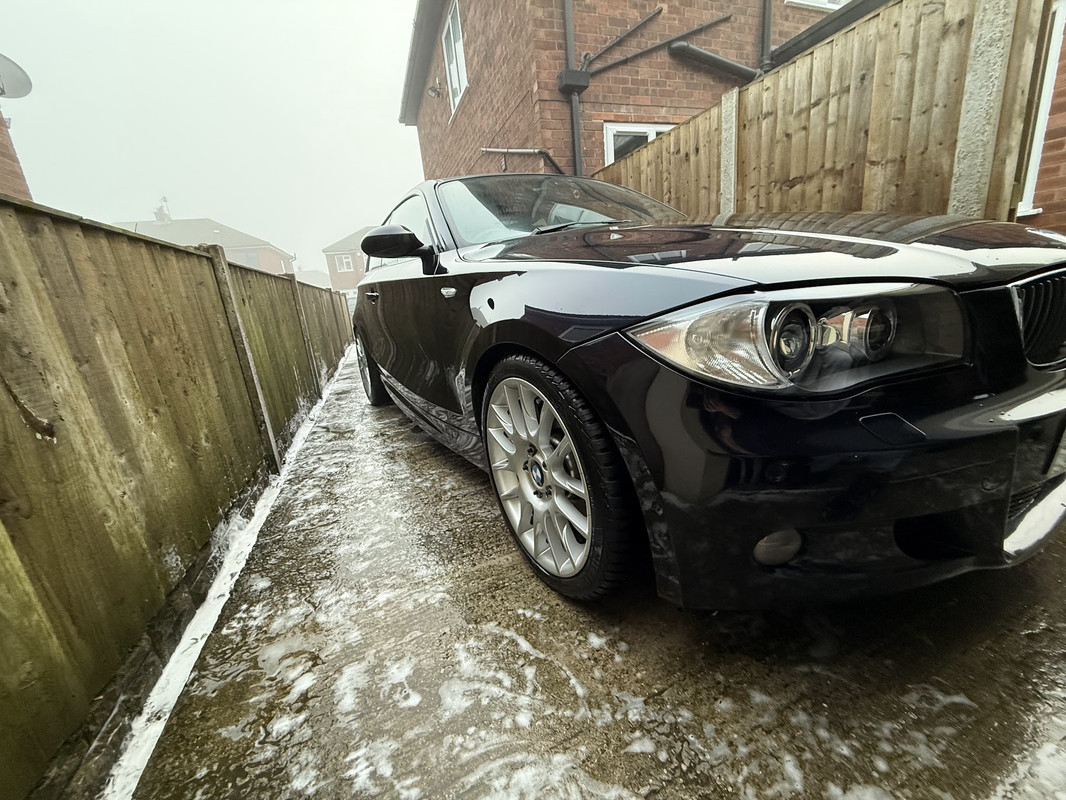

My 1st ever 'Baby BMW' - 2007 E81 130i LE - UK car
Thought I'd pop this in here as the UK section is dead by the looks of it; and I've lots of pictures, so it's more relevant
Bought this back in September last year as my '£5k weekend banger' Im work from home and rarely leave the house during the week, so didn't want to spend more than £5k on a car that's just going to be for the weekends... But it needed to be a manual and interesting...
I had thought of an EP3 or FN2 CTR; but didn't like either of them; at 6ft 4 they didn't have me sitting very well; but the interiors really put me off as well.
I came across this 130i by chance and had to have it (manual, N52 straight 6, great sound etc). So travelled to the south of the UK and bought it; drove it back home. A 14 hour day all in due to slow trains down and messy motorways on the way back

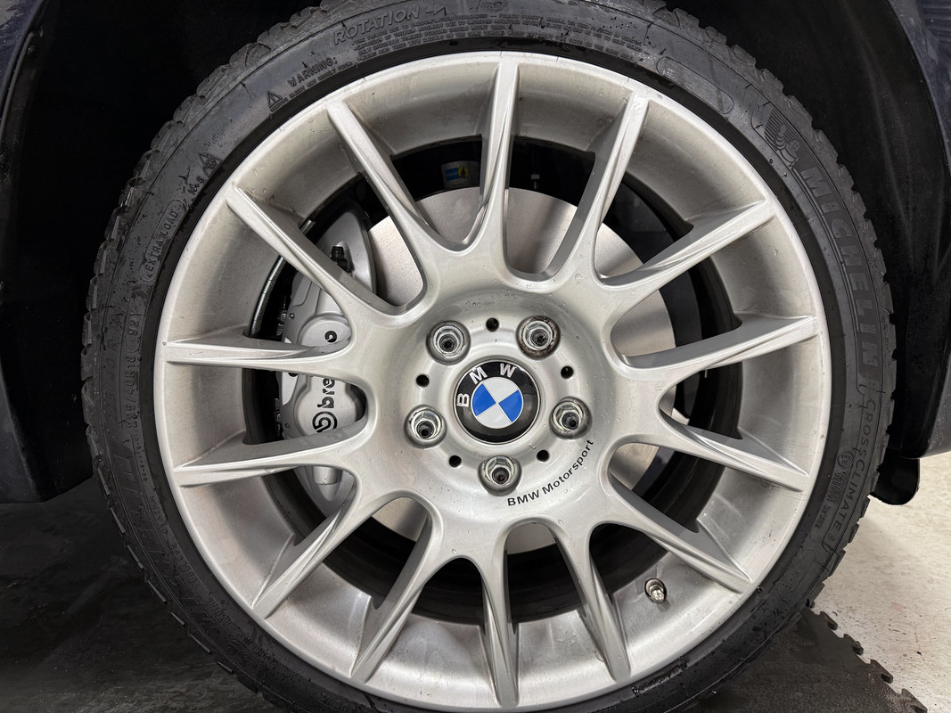

I'm making it my own; very recently just fitted the OEM F3x 340mm Brembo front brakes with Brembo 2 piece discs and Pagid Street+ pads (both superb); and will soon be doing a full suspension overhaul (all arms, links, ARB (sway bar) bushes, track rod ends etc, and then I'll make a decision on whether to fit coilovers (Bilstein B16s, KW V2 'Komforts', ST XTAs or possibly BCs etc); or whether to go for a dedicated & professionally spec'd Birds B1 kit, which is Bilstein/Eibach, but made to their specifications etc
And then I'll sort another set of alloys for summer tyres, as the current 216s have Michelin CC2 all-seasons on to see it through the winter etc
Some recent pictures:
It currently sits on Bilstein B4S shocks, Eibach pro-kit springs with OEM 216 wheels with 225/40 and 235/40 18" tyres
OEM exhaust (valve kept open) and the OEM intake box but with the Mishimoto intake piping and the OEM BMW dry K&N filter inside the airbox
Full project is here: https://www.pistonheads.com/gassing/...f=47&t=2093671
Enjoy

This is how it stands now with all the work done to it:
The work:
  • Bilstein B14 coilovers fitted; ride height set and tracking/alignment dialled in properly with corner weighting.
  • All new arms fitted; inc drop links, inner tie rods/track rod ends etc
  • New engine mounts
  • Whiteline rear subframe inserts
  • New M3 gearbox mounts
  • New OEM BMW top mounts all round; with the pin mod done on the fronts (they just unscrewed)
  • Brembo 340mm front brake calipers fitted with HEL braided lines all round (rear brakes are OEM BMW discs and pads; fronts are Brembo 2 piece 340mm discs with Pagid Street+ pads, with Motul RBF600 fluid flush & refill)
  • Protrack One 18x8 alloys , offset 45 all round, with 10mm hubcentric spacers on rear, 5mm hubcentric shims on fronts (with a 74mm stud conversion) running 235/40/18 Michelin PS4S tyres all round
The only thing I may consider later this year (apart from another set of lightweight alloys and all season tyres for 'winters') is an LSD
