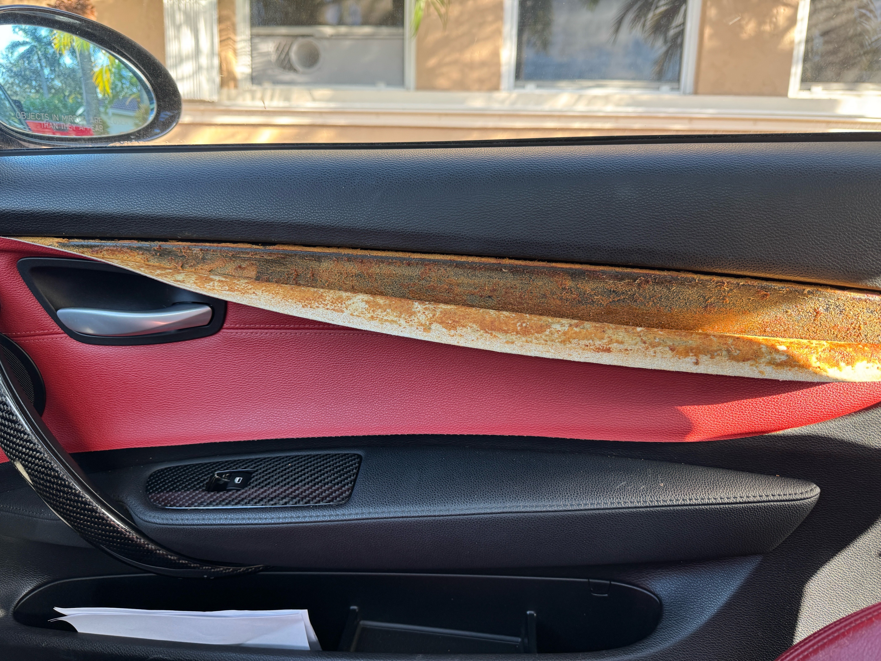

09 128i N51. The leather trim on my door card is unsticking, all over the interior. How can I reglue it in a way that it looks perfect once again? Any recommendations for removing the old glue and replacing with what kind of glue?
Thanks!

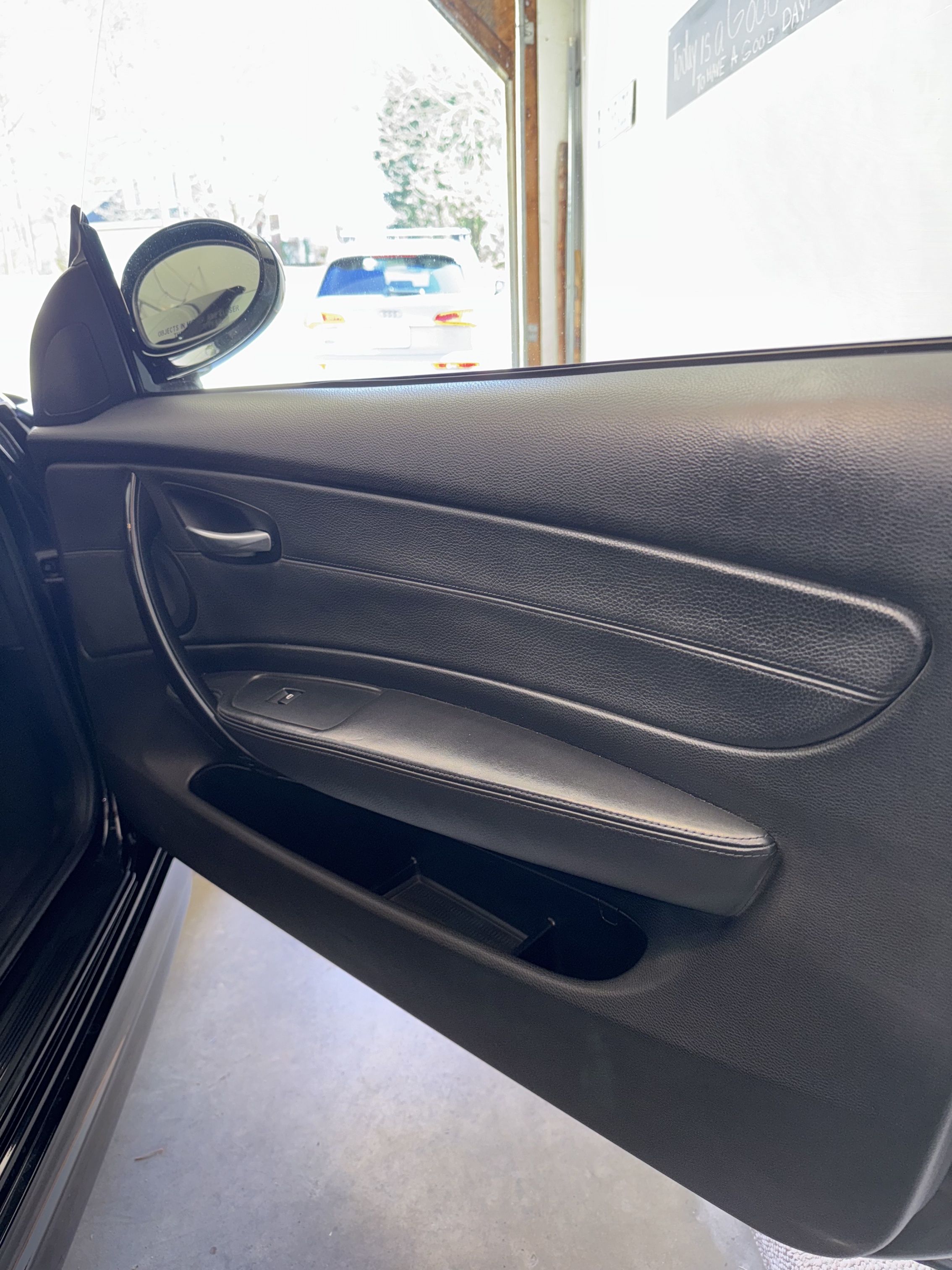

I thought I took pictures of work in process, but apparently didn’t. I did this repair on both doors about six years ago and took the following approach.
I used a clear plastic painters drop cloth and laid it loosely over the whole interior of the car (note I have a convertible so that task wasn’t that difficult). I then cut slots at the door panels and used painters tape to carefully outline the full perimeter of the door cards (where the glue had released). Without taking the door cards off, I rubbed all the glue off the door and the backside of the door cards, up to the door handle and only the perimeter of the speaker. I then used 3M Spray 77 cement on the back of the door cards and the door panel itself. Cleanup was a breeze by just picking up the plastic that had all the glue fragments and overspray from the spray cement. Today pictures attached.

Looks good, though I notice some small bump looking areas? Was this just glue that was stubborn to remove?

Tough crowd😬 Yes regarding the bumps. An imperfection I am fine with.
