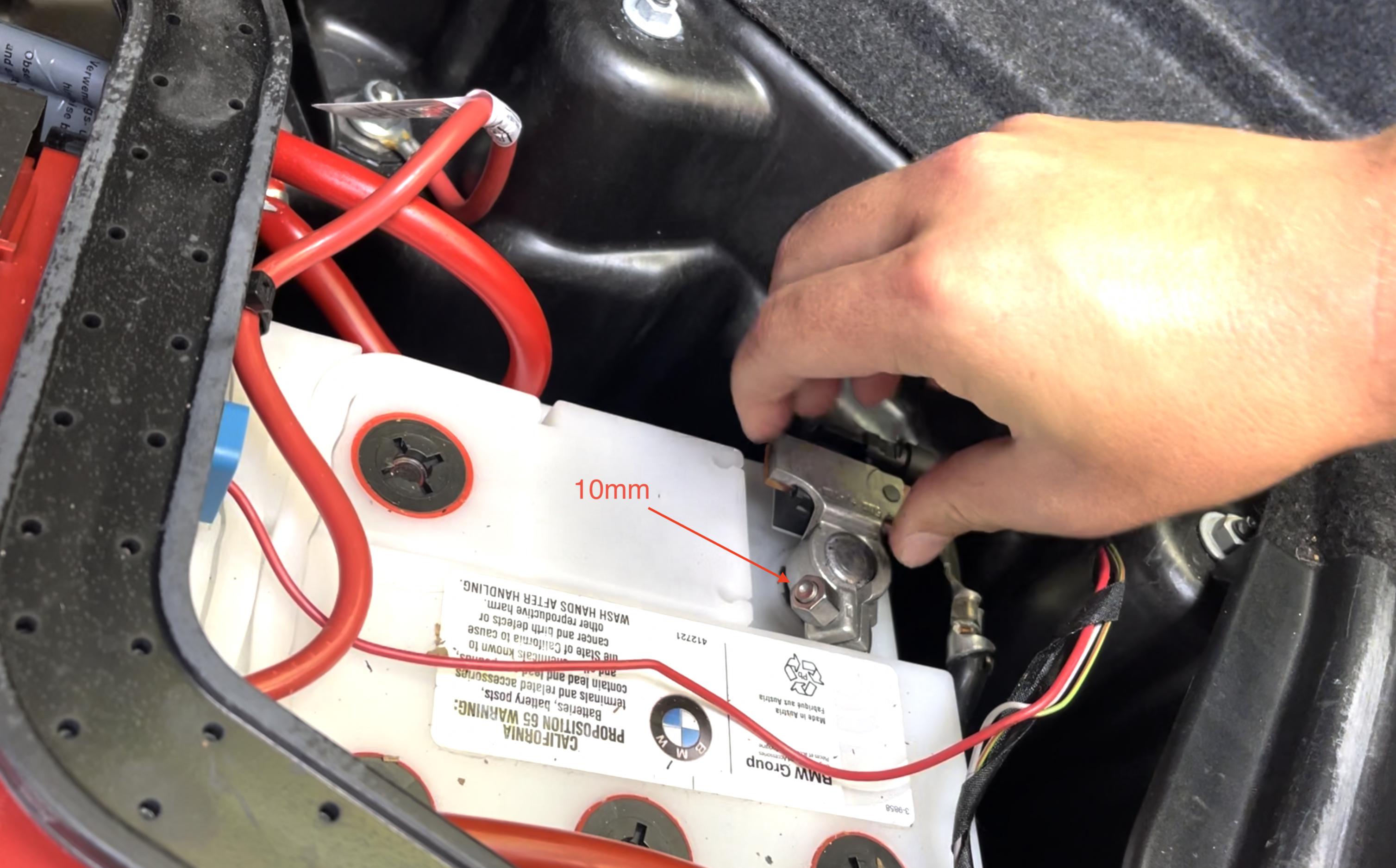

Step 1 - Disconnect battery - Negative (-)/black terminal
People recommend also leaving your lights on to drain residual electrical energy in the system if you don't plan on leaving it overnight or something. This is what I did and I didn't have any issues, but I don't know if it actually did anything. Better safe than sorry
For this you need a simple 10mm socket
(See attached pic)

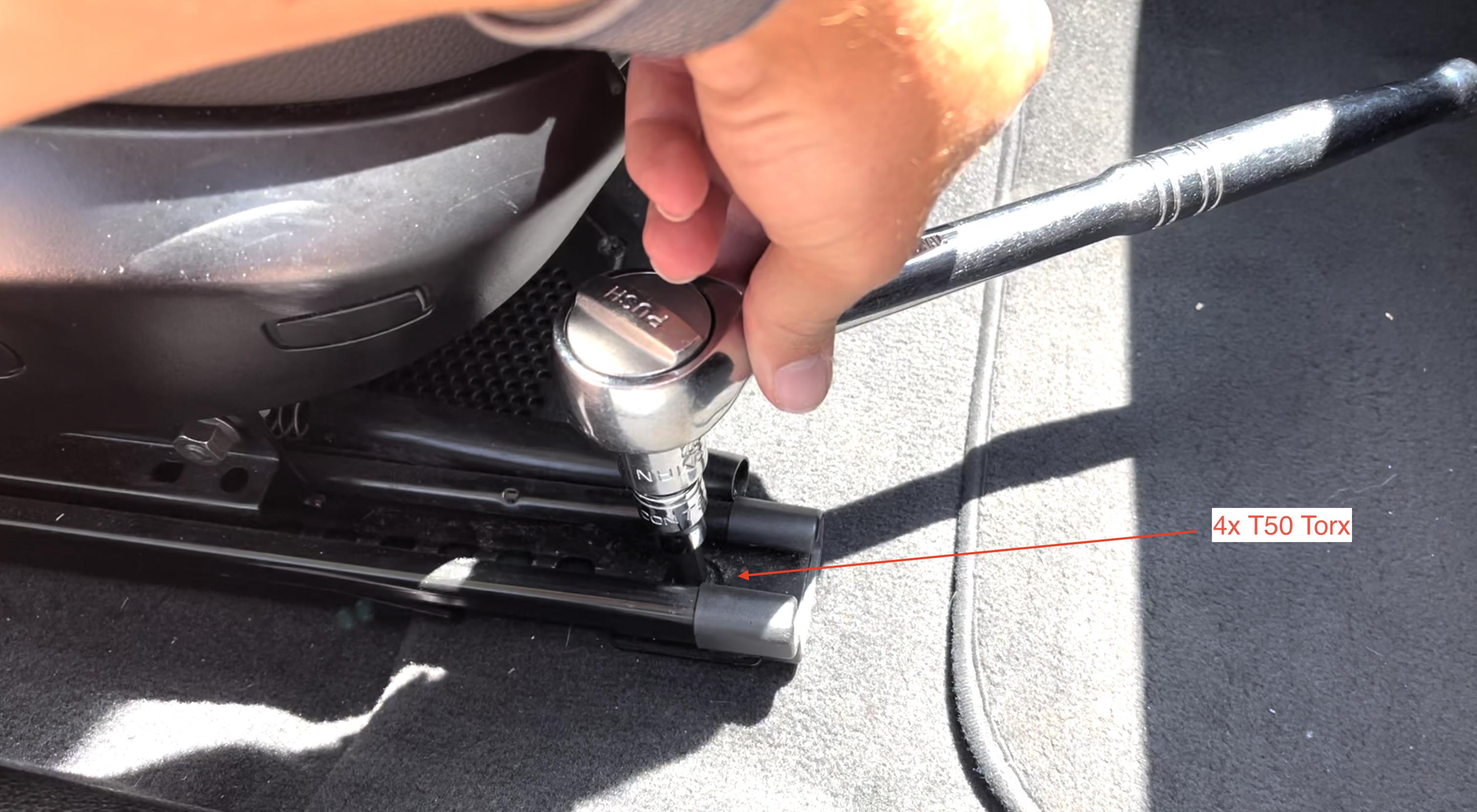

Step 2 - Use a T50 torx bit to take the 4 bolts holding the seat in
You should have just enough room with the seat all the way forward and all the way back to use a 1/2" ratcheting driver, although a 3/8" would probably be easier clearance wise (my T50 torx bit was 1/2" drive).
(See attached pic)

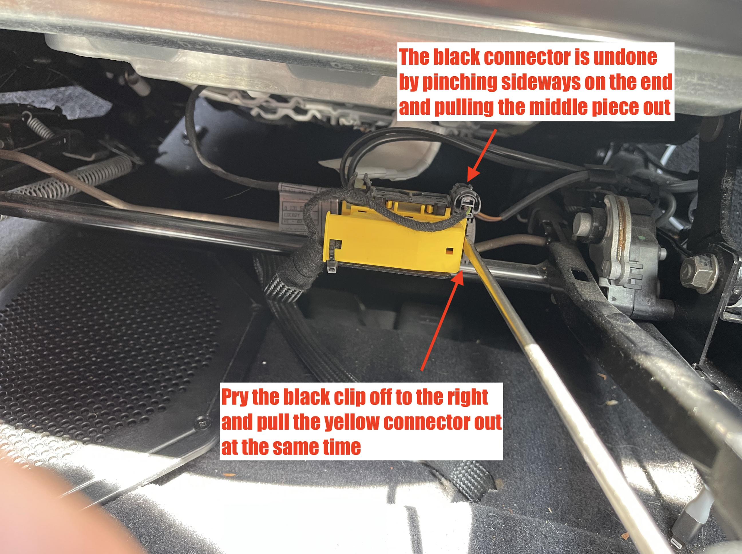

Step 3 - Unplug connections under seat
The yellow connector is undone by inserting something flat like a screwdriver into between the black part on the (right side if passenger; left side if driver; they are mirrored) and the yellow connector itself. As the black piece moves out, the connector moves out of the socket. It's best to help it along as you pry on the black retaining piece/clip (see image below).
This connector can also be unclipped from the seat if needed for better access with the two prongs below it. Same goes for the second small black connector on top of the main yellow one. That connector is undone by pinching the outside sideways and pulling the middle out (might take a sec to get it out first try).
(See attached pic)

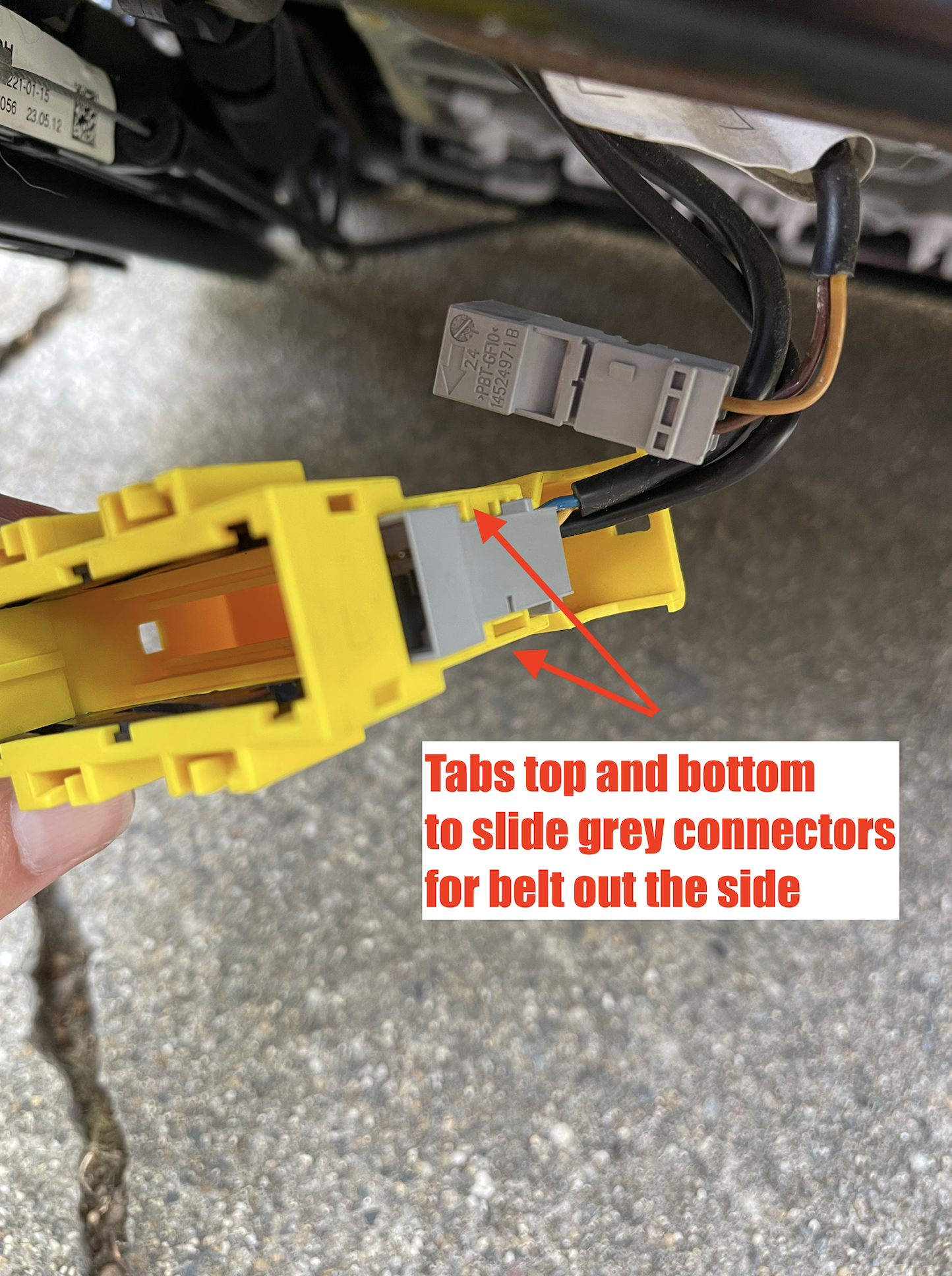

Step 5 - Swapping the belt buckles
So far, this swap will have been pretty easy. Here is where it can get just a tad more difficult.
You will need the same T50 torx bit to take the buckle off. Additionally you will have to cut two zipties that hold the belt buckles wires that go to the yellow connector in place.
After the bolt and the zipties are cut (making sure not to nick the wires), The end of the belt buckle wire can be snapped/slidden out of the yellow connector (which makes this possible). There is a small tab on top and bottom. See picture for clarification (passenger connector)
(See attached pic)
