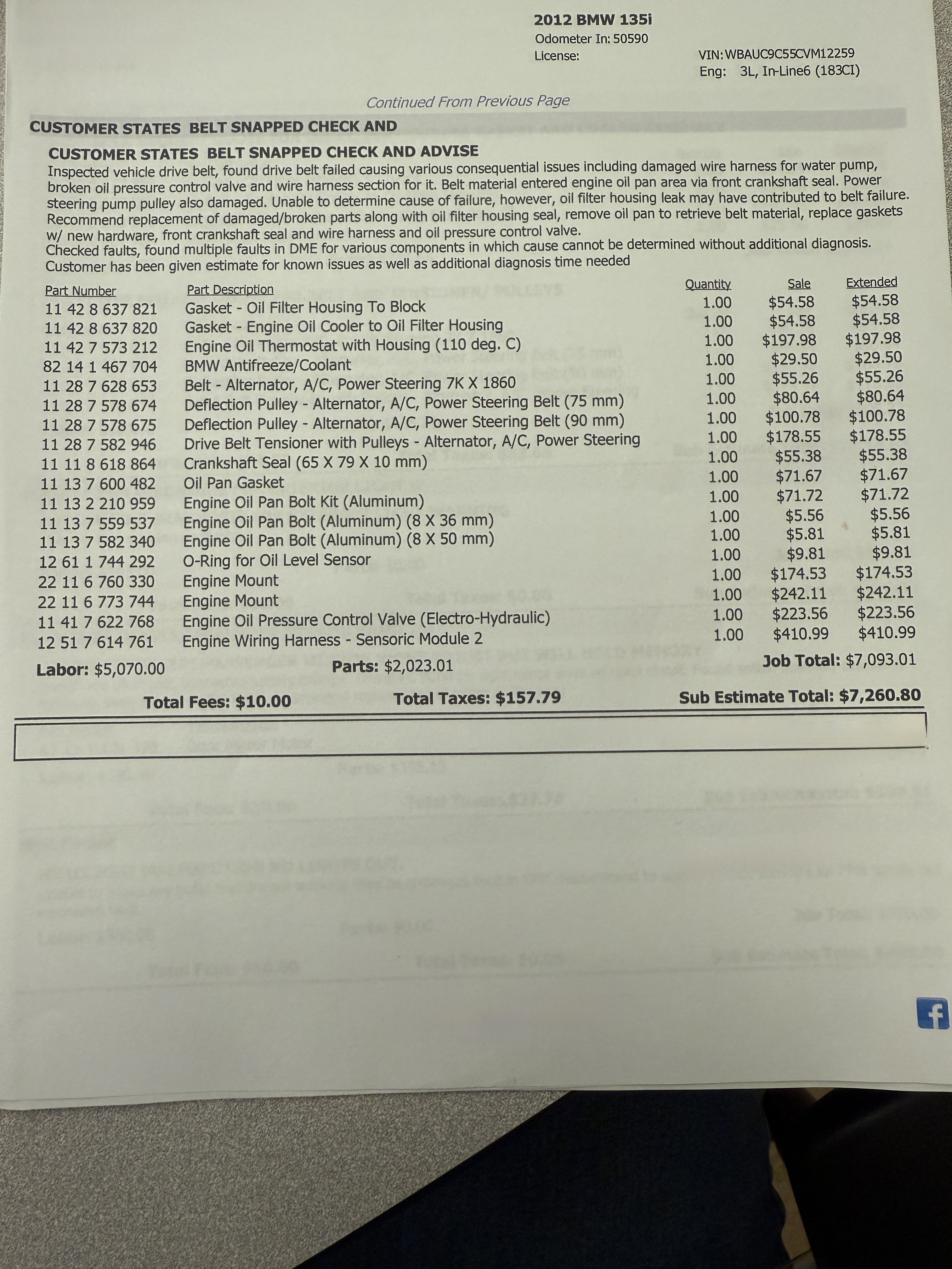

Belt ripped apart the engine harness...total loss??

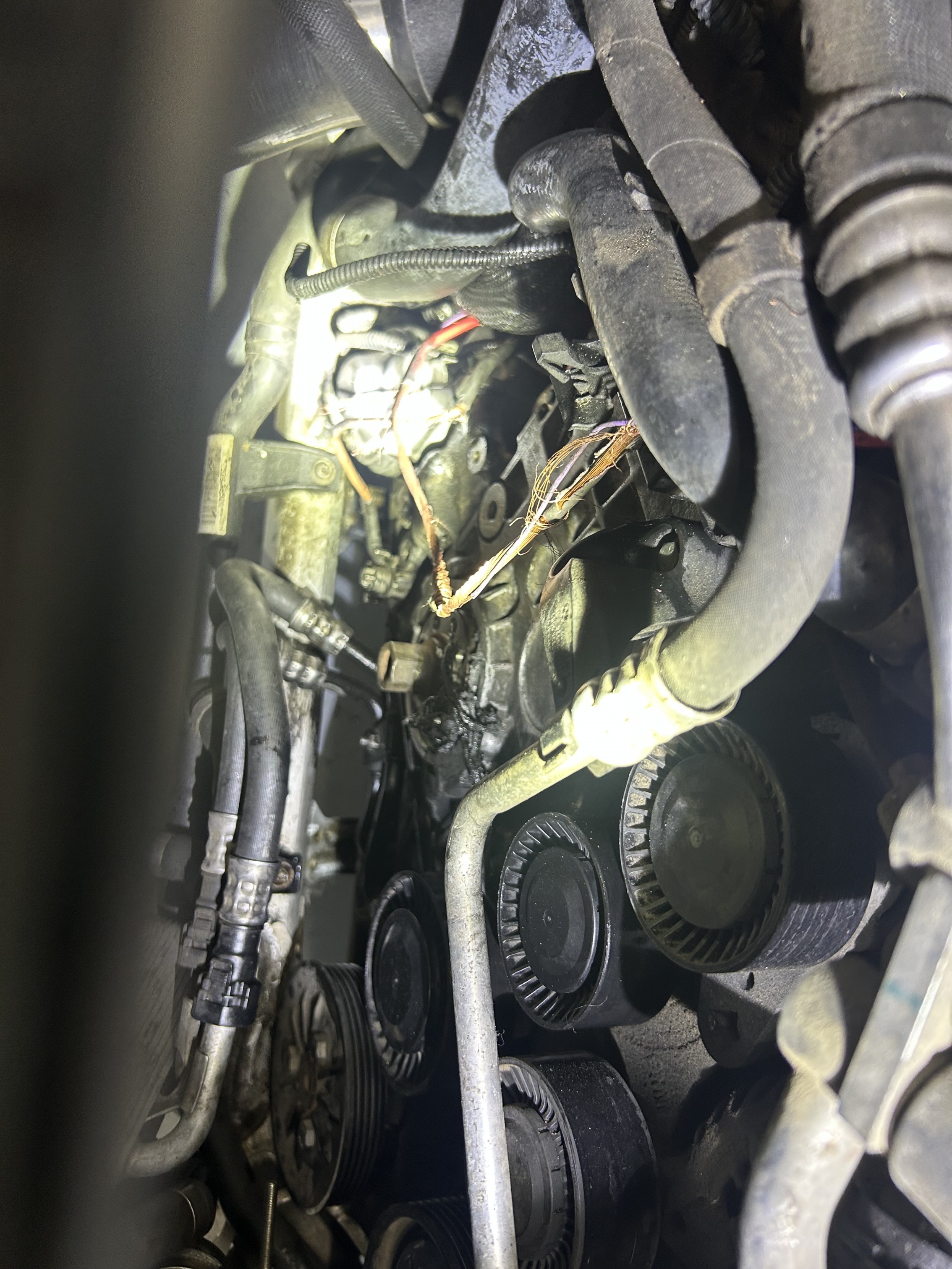

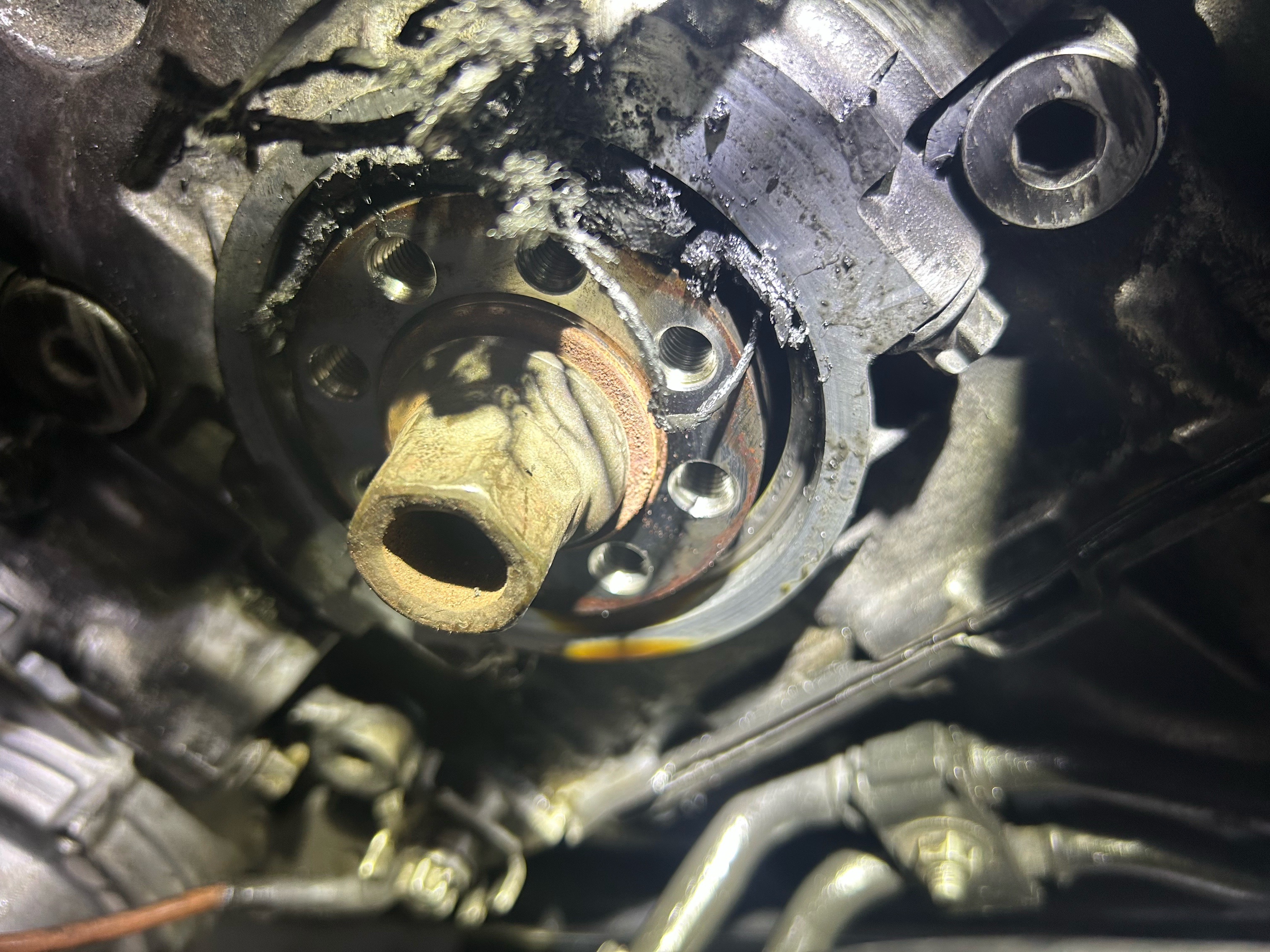

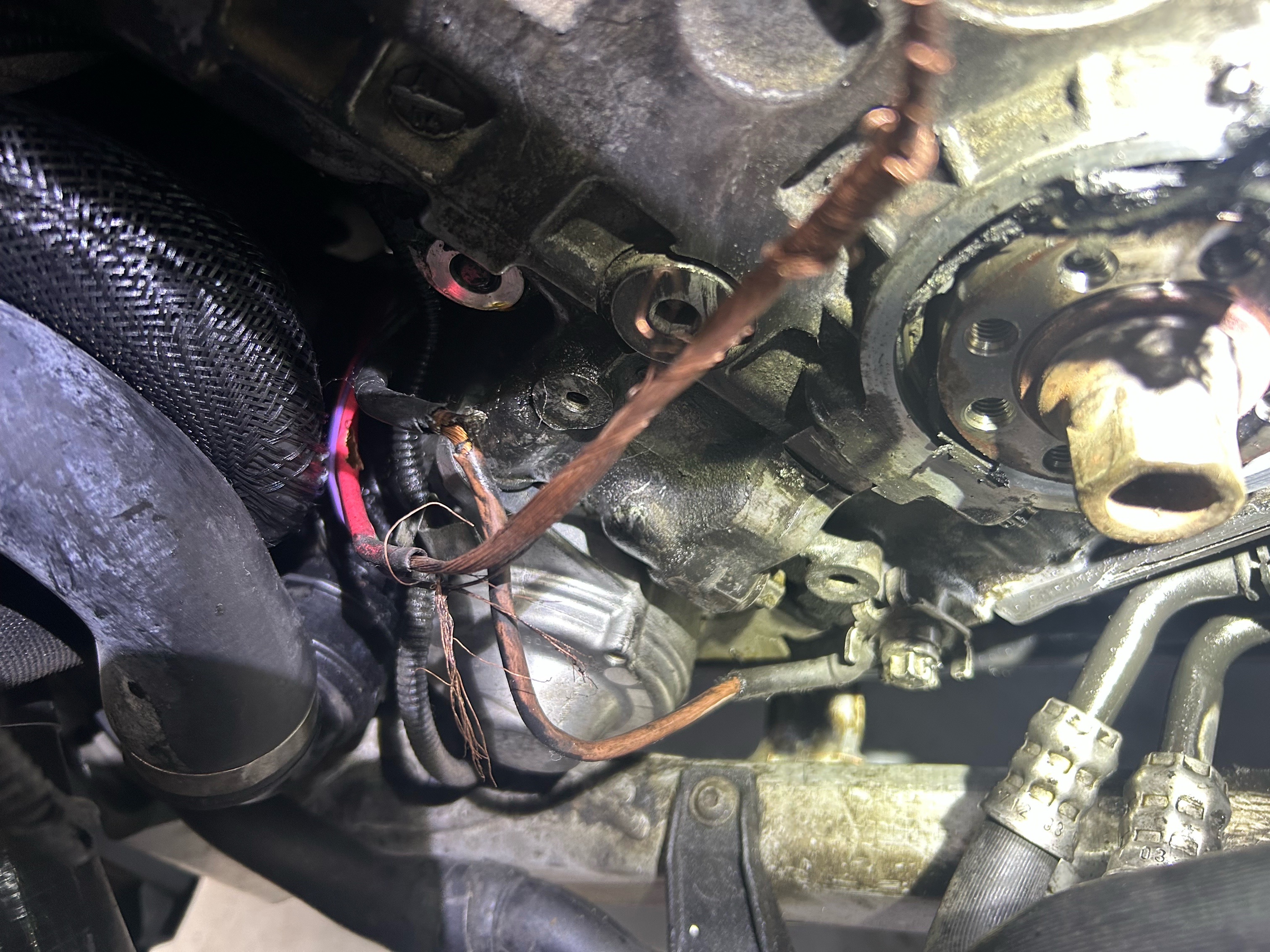

Hello everyone, I’ll try to keep this straight forward and sweet. I’ve had my 2012 135i (50k miles currently) for about 9months and I LOVE MY CAR! Unfortunately the belt ripped off no joke 5 minutes after picking her up from the detail shop to get her fully restored on the outside and she was beautiful…for those 5 minutes 😂 As I came to a stop light the revs jumped up and just new something was off…I heard something pop followed up with some slapping on the front end seconds later, then followed up with a dash board full of lights coming on. I was able to pull into a circle k and turn her off in a matter of minutes! Unfortunately the damage was already done and in the worst kind of way. The engine belt popped off and got eaten into the front crank seal and while this maybe is the worst case scenario it gets worst….when the belt broke it ripped apart the engine harness and took it for a spin. I have the car at my mechanic shop and here’s the news. One of my pulleys have shattered along with destroying most of the others(as expected) ripped apart the engine harness. I have material in my oil so have to take off valve cover and drop subframe to clean everything out and hope that nothing has worn down or damaged itself. THEN we can start to repair the engine harness which is just a night mare. The Indy BMW shops here in AZ all have a liability clause so they don’t allow you to bring your own parts even if they are OEM ( I get all my stuff from FCPEURO and ECS) and rather they buy directly from the dealer ship 😤 this has made getting the repairs I can’t do ( I live in a apartment complex with no garage) insanely expensive. They are getting a whole host of codes they can take care of once it’s finished doing those repairs and they say the engine is completely salvageable BUT they are seeing a code they’ve never seen before (don’t have it on hand but will update later) regarding a power distribution code I believe it was. They think when the engine harness was ripped off it caused things further back to get unplugged or possible loose a grounding cable (best case scenario) or it further ripped apart some things down the line. So in order to find out I would need to repair the car and all the damage to get her turned on and running before they can truly dig deeper to find out that issue…the quote for this job is $7200😯 this is something I’m willing to pay because I love my car and simply don’t have another one to drive and wouldn’t make sense to buy another car and go further into debt when it would be less debt to repair this car. This is my logic, Please help me understand is this even worth it or is it a lost cause ?!?!

Update Pt.2
After talking to the shop and getting better clarification on everything that needs to be done things aren’t looking that grim. They assured me the engine will be just fine with no issues once all repairs are done! They informed me when the belt gets forced into the front crankshaft that the timing belt forces the belt downwards into the oil pan where the pick up lines will suck up the bits. There is no need (for now) to go through the top and remove the valve cover and doing anything up top.
Game Plan
This job is very labor intensive…
1) Dropping oil pan, which means subframe has to come out. At least the oil pan gasket will be replaced 🤌🏻
2) clean out all belt bits from the pan, oil feed lines and screen inside of the lines.
3) replacing engine mounts as they are have easy access with subframe out and needing to be done as we put it back together(PM)
4) replacing Crankshaft seal, switching to the front bottom of the engine now. The shop is cool with me buying the Tuner Motorsport crank seal guard and crank bolt capture- https://www.ecstuning.com/b-turner-m...9453la01-02~a/
https://www.ecstuning.com/b-vargas-t...t-s55-cbc~vtt/
5) replacing belt tensioner w/pulley, deflection pulleys and belt.
6) OFHG & Oil cooler Gasket w/engine oil thermostat housing. Cracking open all these lines to follow up with cleaning everything out and making sure to get all belt bits cleaned and added preventative maintenance(PM).
7) Lastly Engine wiring harness- Sensoric Module 2! The part that gave me the most anxiety when they told me the news lol the plan before this was to splice the wires where needed to repair the harness but after ShocknAwe gave great insight about future electrical gremlins that can pop up I opted for replacing the harness entirely especially seeing I’m buying it anyways. Don’t want to stay awake at night thinking something else may go wrong.
Still needs work

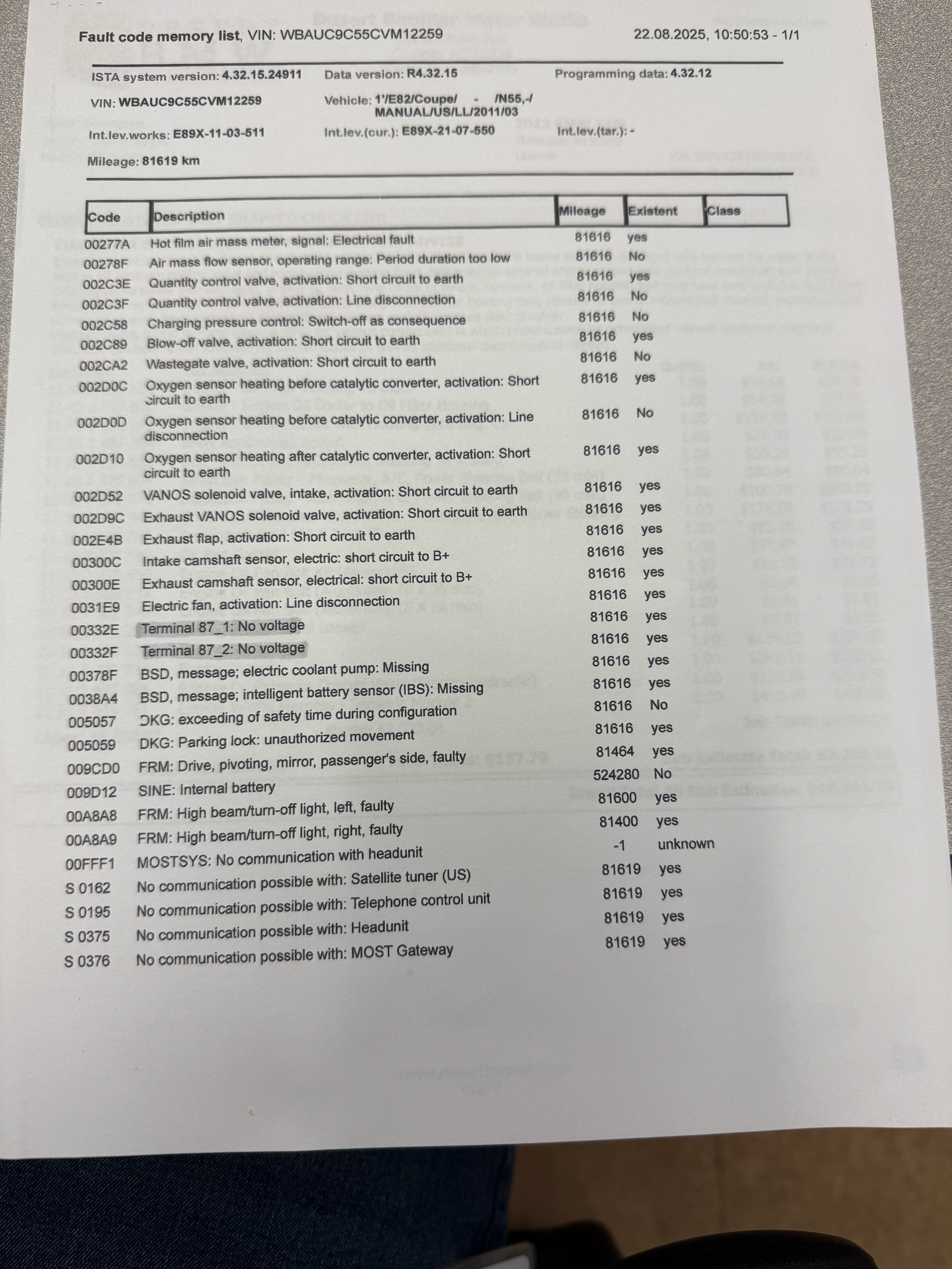

They have assured me all but two codes will be cleared and resolved once these repairs are done. They are still getting two codes(essentially the same one) which they haven’t seen before which they can’t fully diagnose until the car is running and has oil pressure ect. The code(s) is Terminal 87_1: No Voltage, Terminal 87_2: No Voltage. This could be as simple as a blown fuse and or loose ground(or both) and just like that things are good to go! OORRR the engine harness that got ripped and pulled damage things down the line (even more doomsday news for my car and wallet) which we won’t know till things are back up and running. Will keep you guys updated! Won’t have her up and running for at least another 2ish weeks. Approved the repairs yesterday morning and waiting for parts ect before work will commence. Shop will try to take pics along the way for me so I can show the damages and how things are progressing.
