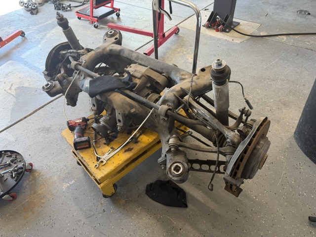

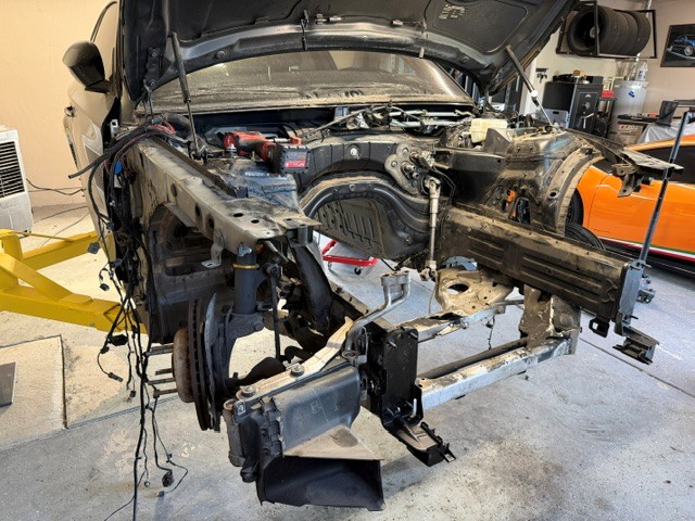

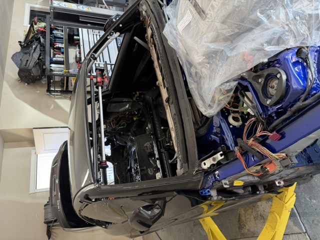

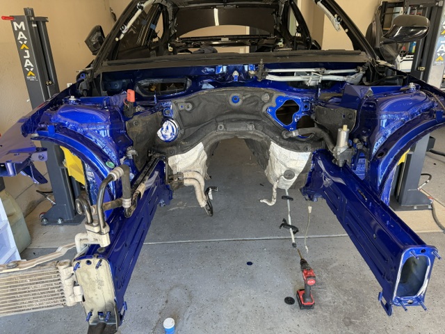

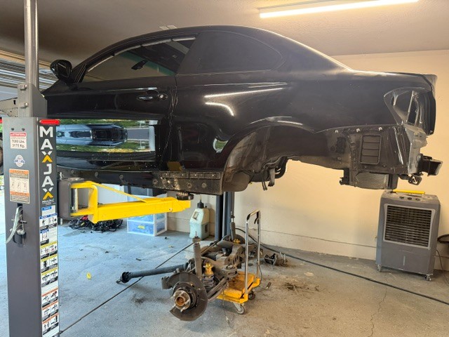

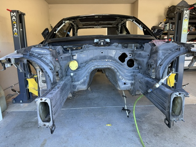

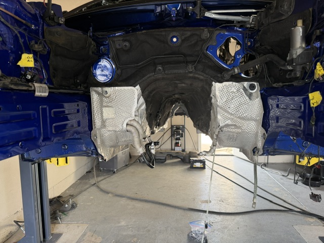

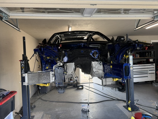

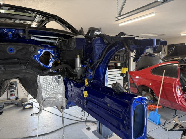

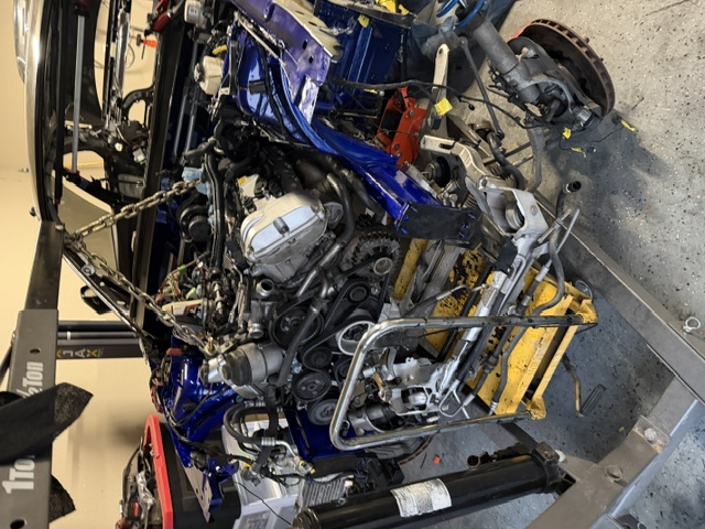

135i Tear down

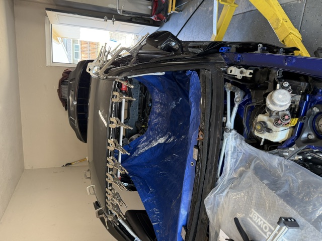

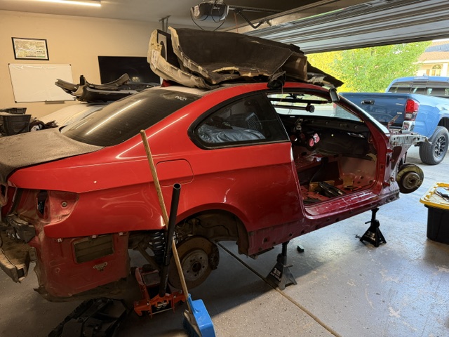

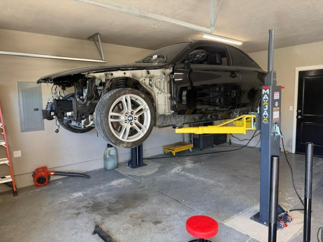

While I was looking for the M3 donor car I started tearing down and parting out what I didn't need out of this 135i so I didn't take any photos. Mostly ripped out the stock drivetrain and sold some of the body panels in order to reduce my cost of the car. One thing I was really excited about this time around is having a lift. Even though it's only 4 feet of ground clearance it makes all the difference in the world. the crash outs were at a minimum.
Size:  100.9 KBName:  3.jpg

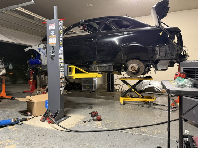

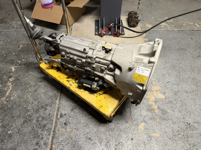

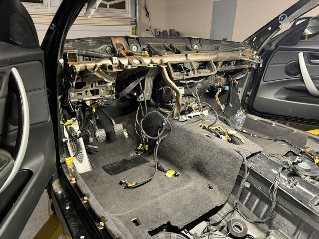

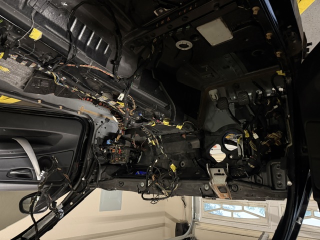

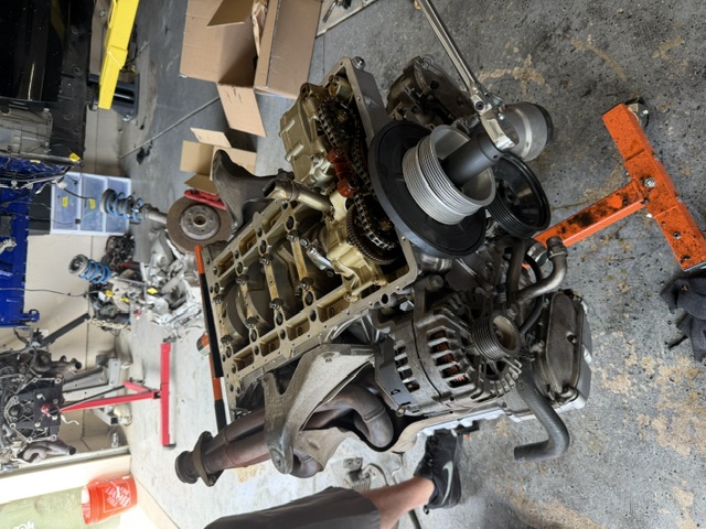

After the drivetrain was out I decided that the 135i was going to live on the lift until it was done and the donor car would be stripped on jack stands instead of trying to shuffle cars around.

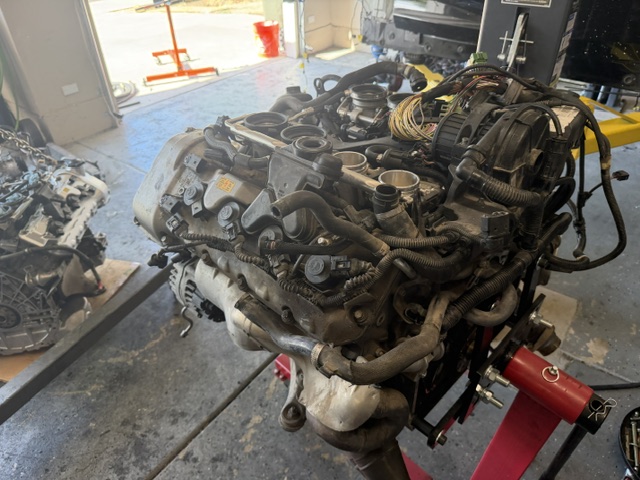

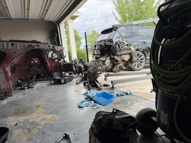

Took awhile to find the donor car and I got bored so kept the tear down going and got the factory harness out.
Size:  93.7 KBName:  9.jpg

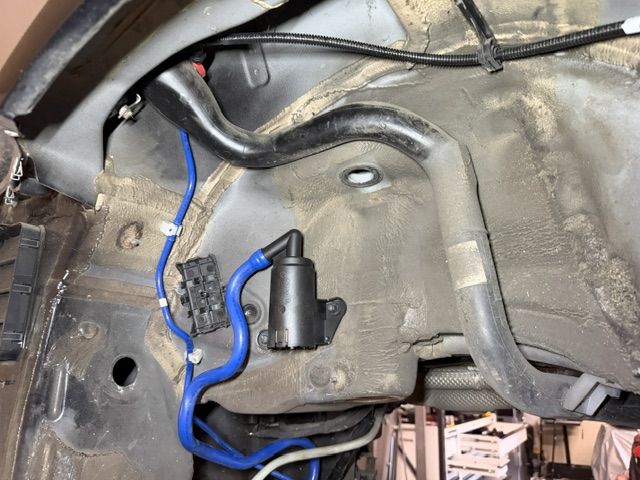

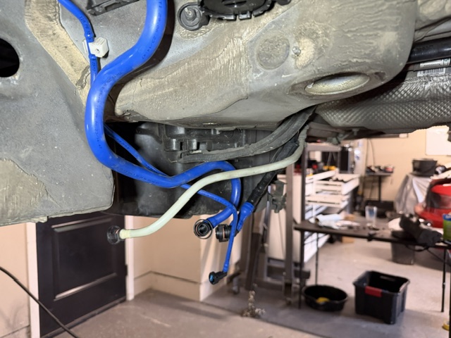

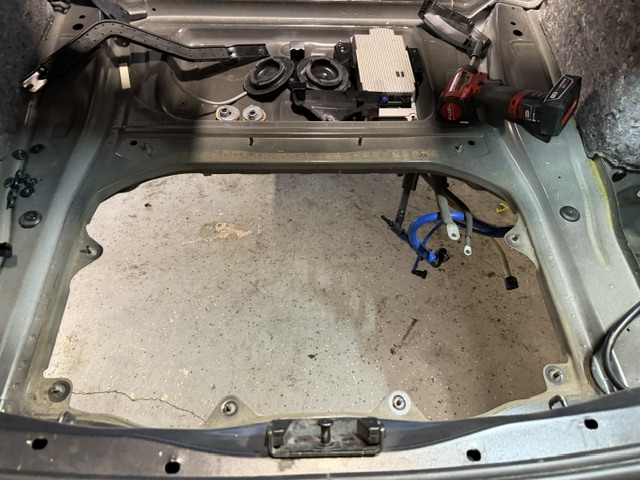

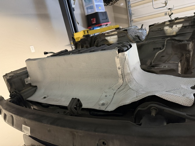

Last time I did this swap I was following several DIYs. None of them mentioned the rear tub and evap lines that need to be swapped. Now I realize that is common knowledge when it comes to building a clone but at the time I didn't. Of course I figured it out once I had the rear subframe back in and had to wrestle the lines in place because I was being too lazy to drop it back out.
This time it was the first thing I did. Nothing exciting. At this point the donor was sourced (Thanks Ryan) and was just waiting on delivery.
Size:  171.4 KBName:  IMG_3215.JPG
Size:  173.4 KBName:  IMG_3216.JPG
Size:  154.5 KBName:  IMG_3218.JPG
Size:  118.0 KBName:  IMG_3219.JPG

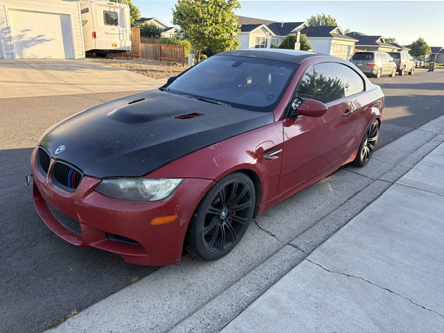

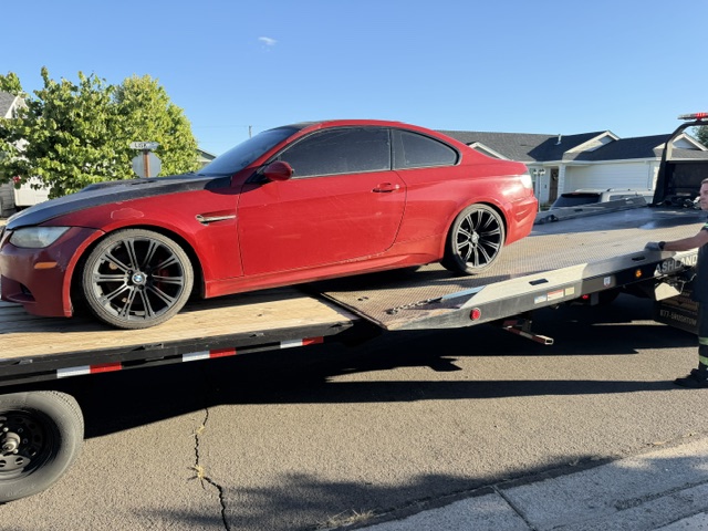

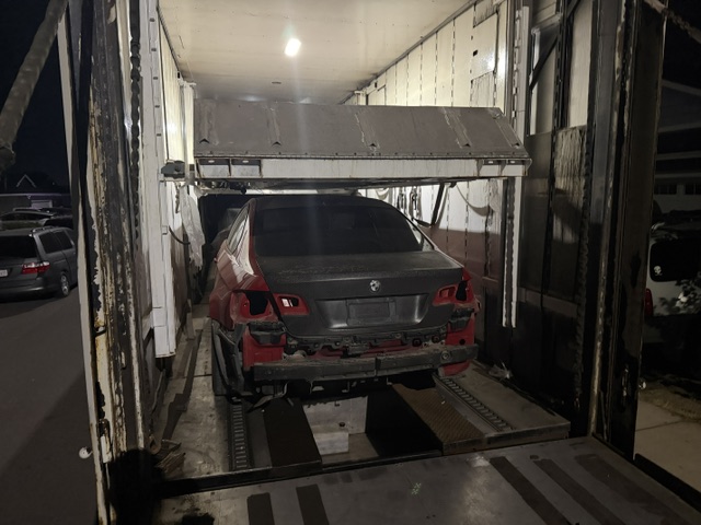

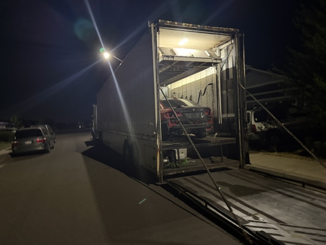

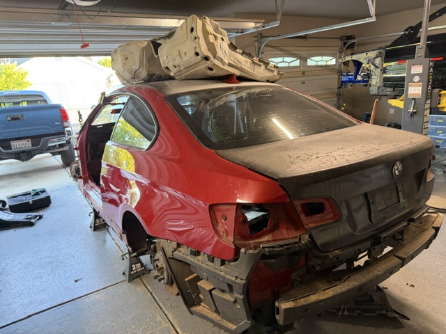

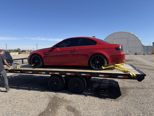

M3 Donor Delivery
Well it wasn't much of a looker that's for sure. It was honestly a shame that this car had a rough life. It was a carbon roof away from being a killer spec. Manual Melbourne over Extended Bamboo. Shame. Time for a second chance at life in a new body.
Used a hot shot driver that just needed a load as he was coming back home from Texas and as it was a rough car I really didn't care. Bite me in the ass a bit as his trailer was pretty high. Was able to load it at pick up with a fork lift but once it got to my house it was not going to happen.
Had to call my works tow department to send a flatbed in order to get it off.
Can't complain. New Mexico to Oregon for $1000. Can't beat it.

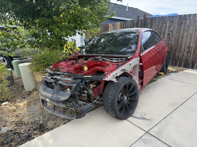

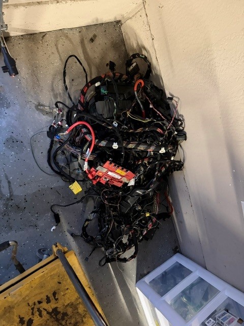

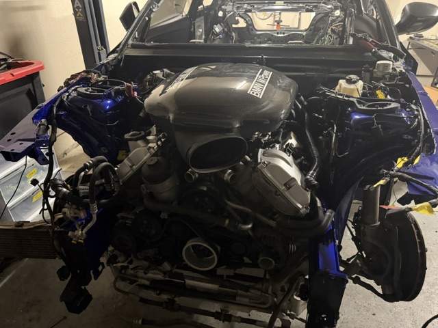

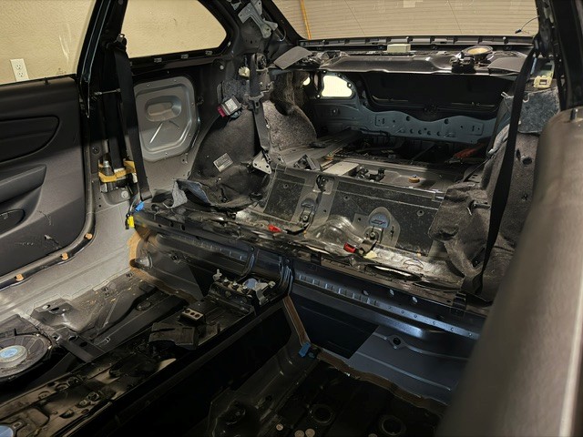

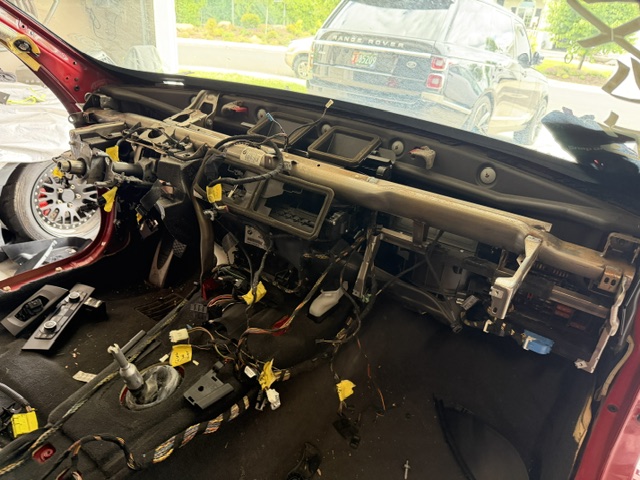

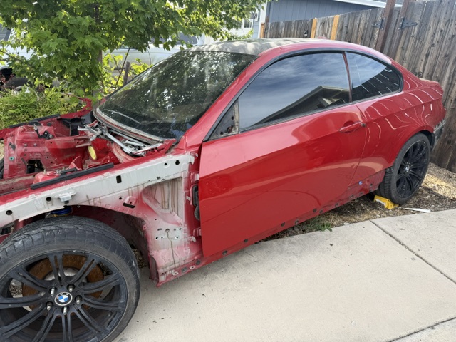

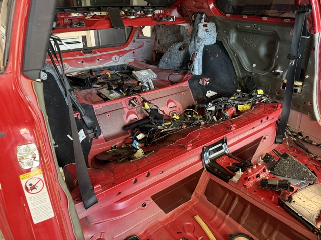

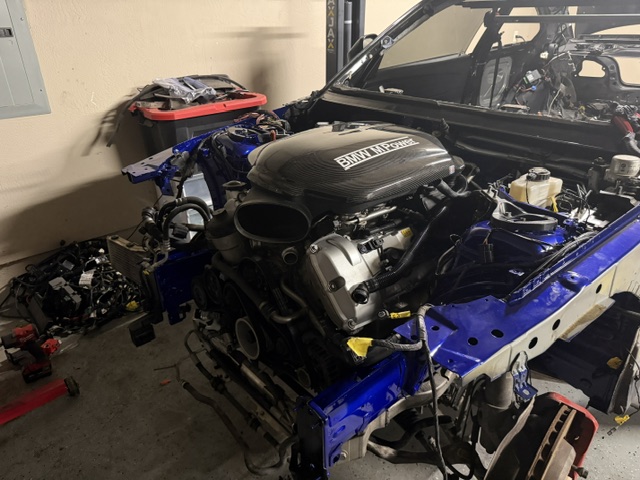

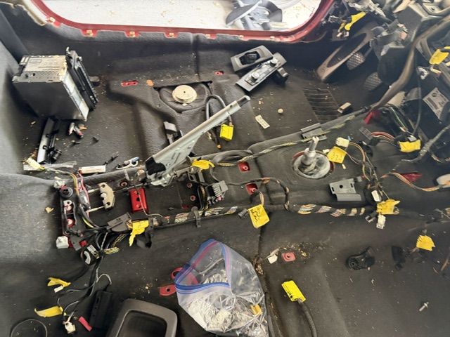

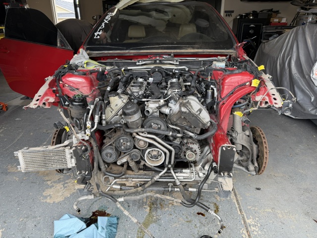

Quickly got busy disassembling the car. The nice part about doing this once already is being able to gut the car and save only what I need. Last time I had parts everywhere because of the fear of throwing something away that I would need. Not this time.
Quickly gutted the interior and had the drivetrain out in a weekend. It's leaking from every seal possible but hey if it's leaking oil that means it has oil. The BMW slogan.
Overall everything was in great shape. Disgusting, but in great shape.

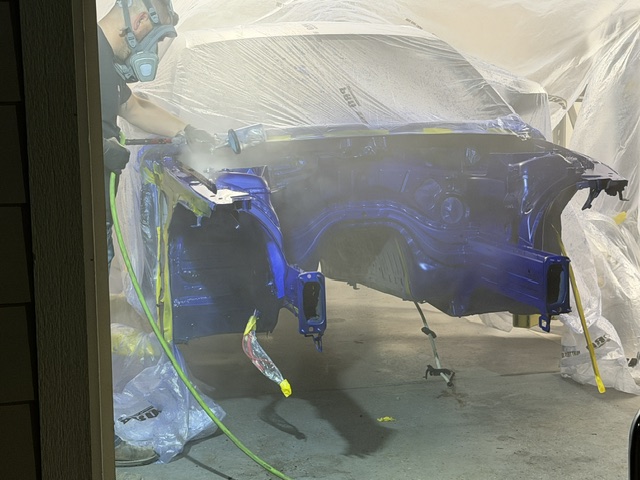

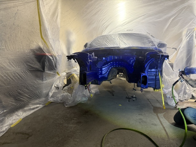

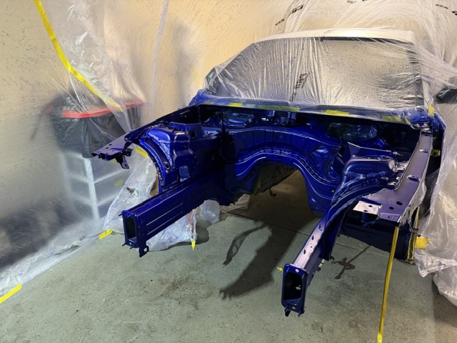

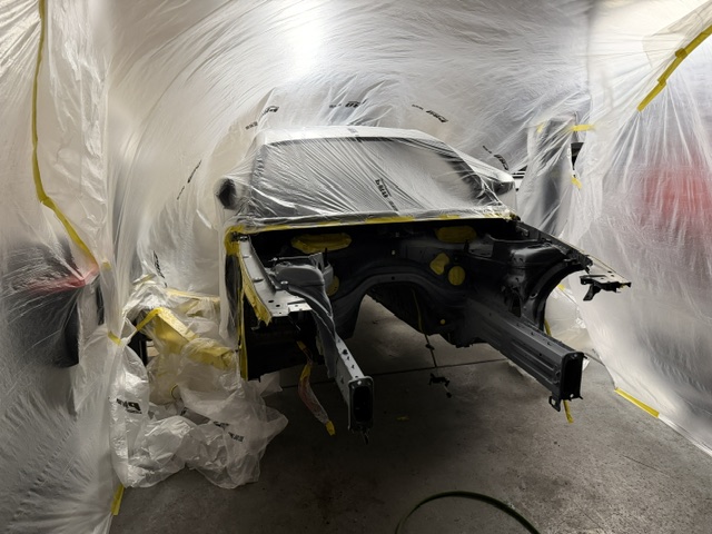

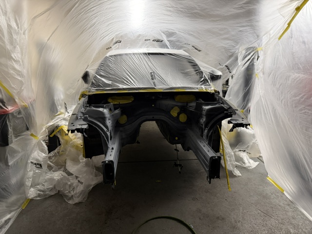

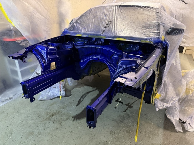

Color Choice and Engine Bay Painting
My favorite/least favorite part... picking a color. I'm very indecisive. Last time I kept changing my mind about the color that I decided to shoot the engine bay satin black just in case one day I woke up and decided to repaint the car. Normally I just google colors and cars and come up with a list of colors for my painter to shoot spray outs on. Normally don't care which manufacture the paint color comes from as long as I like it but this time I was keeping it BMW. Don't get me wrong there are a LOT of great Bmw colors the only problem is most of them I don't think would have looked great on a "small" car like a 1 series. Usually need a bigger body car like a M3 or M5 for it to look great.
I decided on San Marino Blue after seeing an M2 Comp in this color. Simple but a beautiful color and a dark blue Bmw is never a bad choice. This time I was fully committed. After pressure washing the engine bay 3x I finally got most of the dirt and grime out. Then started sanding and prepping.
Made a Dexter style kill room for a paint booth. This was easier than turning the car into a roller and trailering it to work and then bringing it back. Color changes a lot depending on light. No regrats.

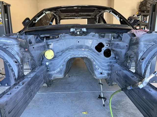

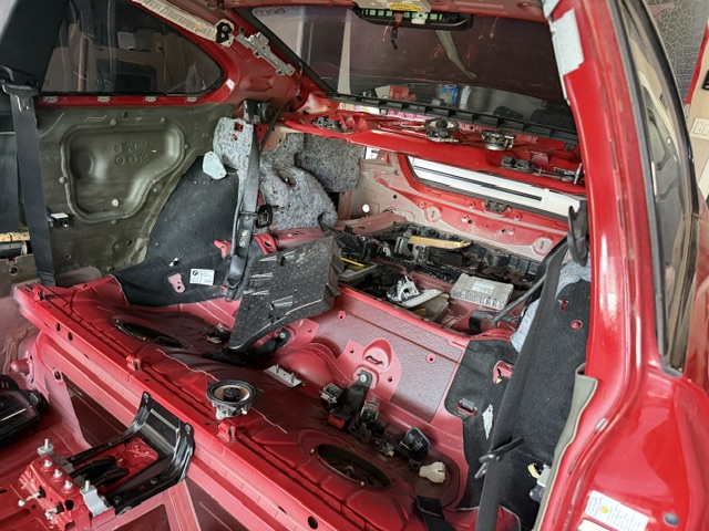

Gutting the M3

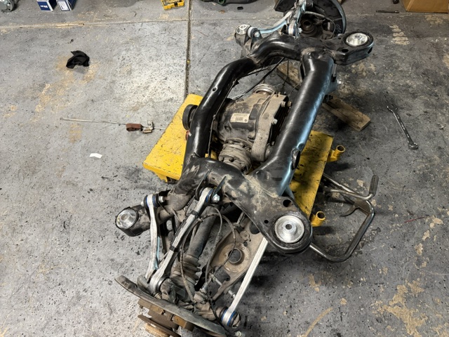

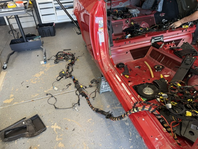

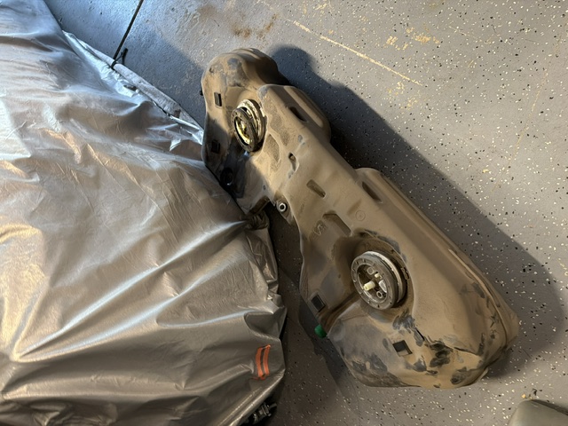

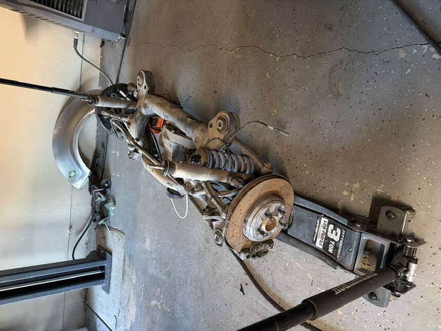

I was running out of garage space so I needed to finish gutting the M3 so I can kick it outside.
Finished yanking out the body harness, fuel/brake lines, rear end, and the fuel tank.

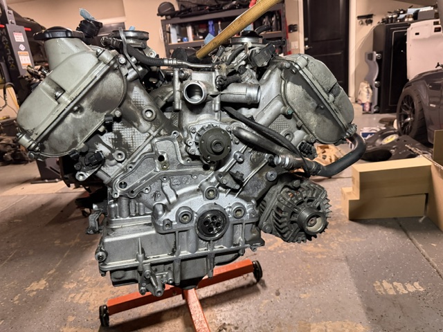

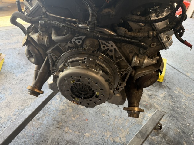

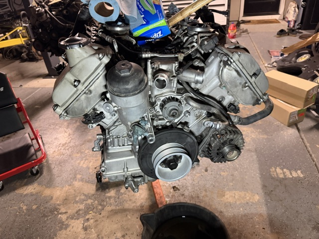

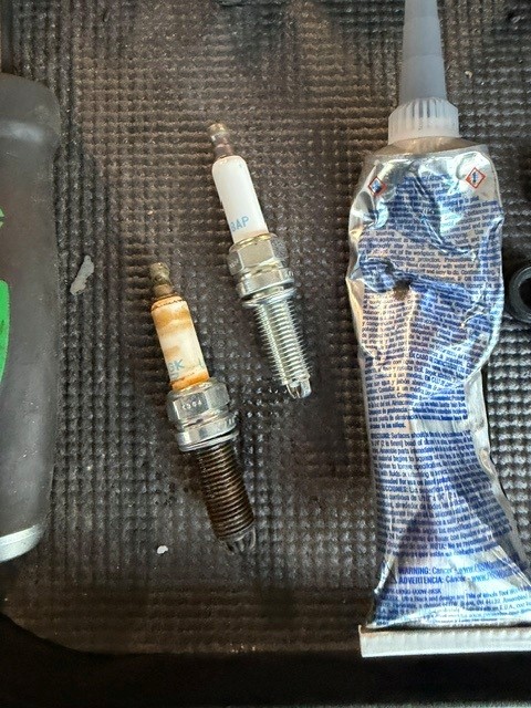

Engine Reseal In Progress

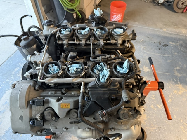

Time to start working on the engine. Waiting for my BE bearings and valve covers to arrive still so working on cleaning the exterior of the engine and replace the seals that I can. Here's the engine without touching anything on it.
Size:  166.0 KBName:  IMG_3476.JPG
The oil filter housing has been puking for awhile it appears and same with the valve covers. Looks like someone has replace the front crank seal at some point but getting a new one since I already ordered it anyways. Here's everything all apart and kind of clean. 6 or 7 cans of brake clean, couple bottles of degreaser, and several brushes.
Starting to look presentable. Still have plenty to do.

Location: Medford, Oregon
More Engine Progress
Got my new valve covers in so I was able to get the top end down. First time replacing these Vanos covers. All my previous S65 cars didn't have enough miles for this to be a concern. Took all the precautions to make sure non of the plastic covers fell into the motor. Got the new ones snapped in and the spark plug tubes replaced. Safe to say this thing was overdue for some spark plugs.
Size:  117.2 KBName:  2.jpg
Even though it costs a lot of money its nice to give the engine a new refresh from top to bottom. Just like that we are good to go. Rotated the engine over a few times to make sure those Vanos covers were properly clipped in.
To top it all off new aluminum valve covers. Just have rod bearings left and a rear main seal.
Size:  106.5 KBName:  4.jpg

Engine Servicing Completed and Rear End Back in Car
Finally feels like I'm getting somewhere. Rod bearings done, front and rear main seal done, just need to dress the motor back up and put the new clutch/flywheel on when it shows up next week. Rod bearings were original and showing typical wear but everything else looked solid.
Size:  197.6 KBName:  IMG_3567.JPG
Size:  173.5 KBName:  IMG_3568.JPG
Rear end got a extensive refresh. Solid subframe bushings, poly diff bushings, new control arms, new sway bar bushings/end links, and got the rear end back in the car.
Size:  179.9 KBName:  IMG_3564.JPG
Size:  206.2 KBName:  IMG_3565.JPG
Ignore the ugly bent dust shield and missing brakes. Waiting for my F80 calipers to show up.

Drivetrain in The Car
Finally got the motor fully dressed again. Also threw in some new throttle actuators I had laying around. I'm so happy to not be cleaning and servicing anymore.
Size:  171.6 KBName:  IMG_3579.JPG
Size:  168.7 KBName:  IMG_3580.JPG
Size:  167.9 KBName:  IMG_3581.JPG
Size:  208.5 KBName:  IMG_3583.JPG
Even thought the old clutch was perfectly fine I decided to throw a new one in. Goal is for this car to drive like it's brand new again. Pressure washed all the nasty gunk off the transmission and then went to install the new fly wheel and what a fight. My home made grounded down T60 was fighting me. Had to grind it down even more and was able to get the flywheel installed. I refused to pay BMW for their special tool.
Size:  191.4 KBName:  IMG_3585.JPG
Size:  191.0 KBName:  IMG_3613.JPG
Then came the big moment. Drivetrain back in the car. I'd say I'm 50% of the way done with this project now. Time to measure for a driveshaft and get that ordered. Also had to mock up my carbon plenum. I still think superchargers look better but this isn't bad.

Carbon Roof Install
Just like last time my brother is going to do all the body work. He won't touch the quarters until the car is on the ground and on it's on wheels. He was able to knock out the carbon roof install in a day while I was on vacation. Didn't get much in photos since I was gone but gets the point across.
Got the old roof off pretty cleanly, cleaned up all the mating surfaces, welded in the roof reinforcement, spread a tarp inside the car, and then panel boded the hell out of the roof onto the car. It was clamped for about 72 hours by the time I came back. Perfect job. Will be throwing a fresh coat of clear on the roof when the car gets painted.
If anyone is curious what panel bond we used it's 3M 07333. The BMW stuff is just relabeled 3M 08115 but 07333 is a far superior product. Same product most manufactures are gluing inner structures with nowadays.
