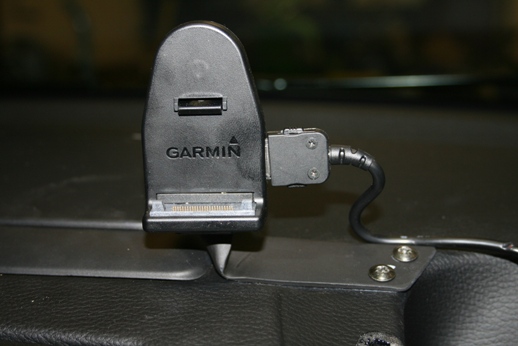

See attached pics of my installation. Not a true hard-wire - power cable and aux audio (not shown) run through cluster pod, transmission tunnel to power socket & aux input under armrest. Very clean, but you don't save the power socket. Bracket is fabricated out of aluminium flat bar.

I like your installation, Carbonic, but I don't completely understand what I'm looking at. Is your car right hand drive? It appears the piece over the instrument cluster hides the screws securing your bracket, right? How does the Garmin connector attach to the aluminum bracket?

The bracket is screwed down under the instrument binacle, which covers the 2 screws. the binacle must have a small slot trimmed from it to clear the bracket.
The standard nuvi bracket has the suction arm removed, and is simply stuck to the bracket with double-sided tape.
Hope this helps.

I like your idea. I am planning a Garmin 760 and may try the BMW mount first. If I do not like that install, then your idea, combined with the Garmin solid stick on mount seems like the next thing to try. I like the ability to rotate the screen which is why I would stick the Garmin mount to flat stock screwed in under the hood for the gauges. It seems like it could be easier to take things out and leave less evidence you modified things this way than the BMW mount - final decision probably has to wait on delivery of my 128i (July) and then a little time for me to mess with it and review the BMW mount. It seems to be a different part number for the wider Garmins than the narrower ones that is in the DIY.
