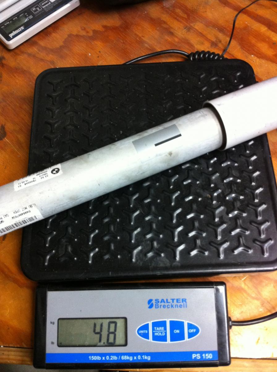

For those counting the pounds, I have also included photos of what the oem strut/spring, rear damper and rear spring weighs compare to the AST 4200. BMW made everything out of alum. and are very light weight. AST is able to step up the to the plate and pack more performance in a even lighter package.
