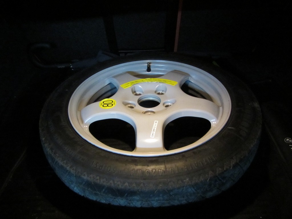

Just in case owners are concerned about using the puncture gung you can get a space saver spare. 17" does fit.

Part No;36.11.2.159.860

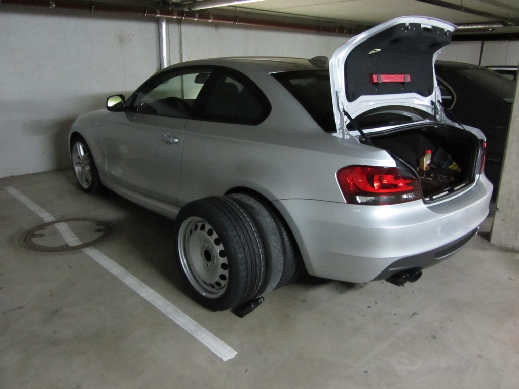

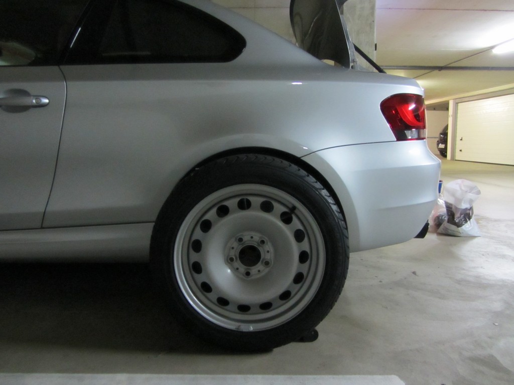

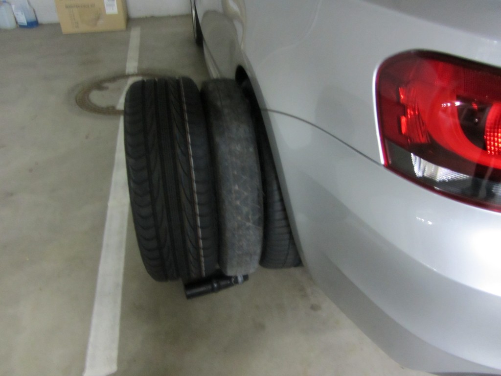

That guy Rick is talking about was ME! And it sucked driving around on that skinny little donut. It does fit on both axles. But I had a flat tire on the rear... and being limited to only 80 kph(on the Autobahn!!!) was too much punishment for me. Plus the rear end of the car was wiggling around like crazy when you changed lanes the tinniest bit! It was very unstable with one 3.5 inch tire on one side and a 9 inch tire on the other side of the car.
Lucky for me, a local 1Addict, Swadeness lent me one of his 18 inch winter wheels, and I drove home on that. For me this exposed the problem with space saver tires. When you need to use one... you really just need a real full size tire. The next week I bought a steel 17" wheel and a 205/50HR17 tire. I also have the BMW jack kit that they sell.

For a 1M you need an 18 inch wheel to clear the front brakes. My steel wheel is a 17 inch dia - min wheel size needed to clear 135i front brakes. My steel 17" is from an e46 330i or e46 M3, 7jx17 wheel.
So you need an 18" steelie... which I do not think is made for BMW's. ? I think your best bet would be to order an 18" alloy from BMW or an aftermarket wheel in that size.
Hope this helps.
Dackel

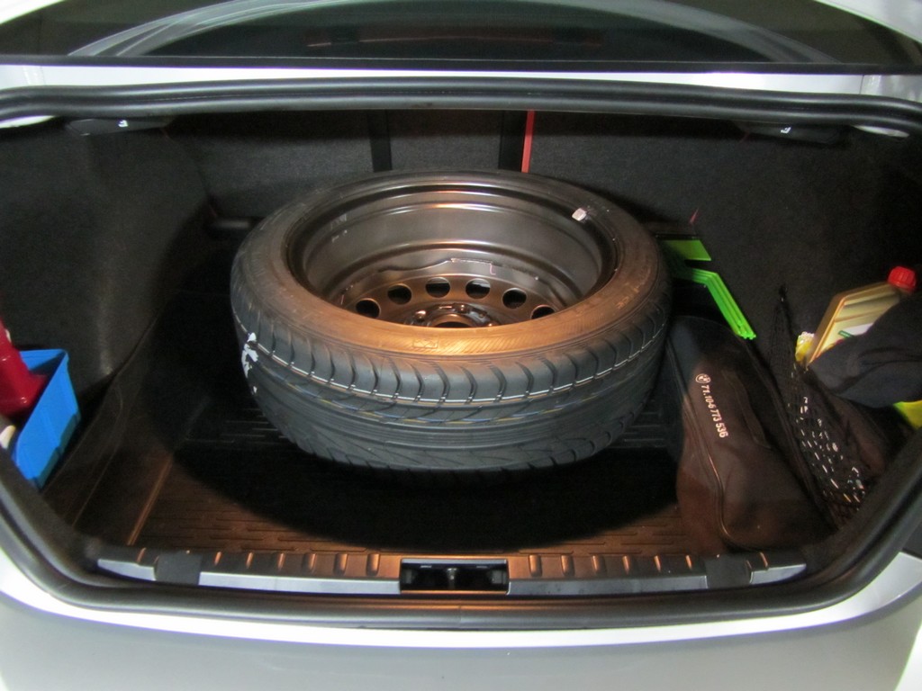

Yup, I have the space saver wheel, and it sits on a shelf in my garage. On the rare occasion I take my car out of town, I throw a full size wheel in the trunk.
