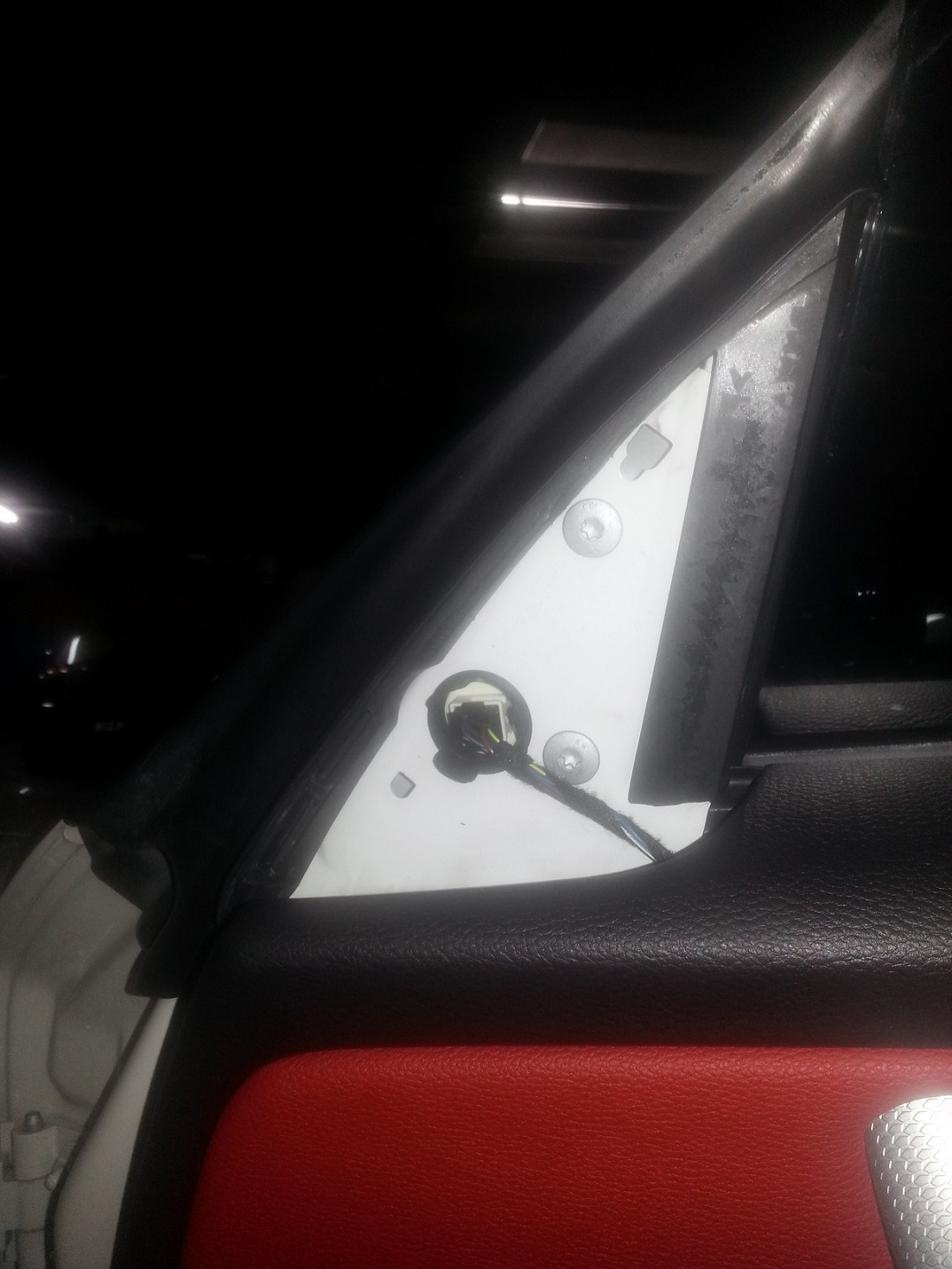

Pic 1 - the triangular sail cover, in some cars may house a tweeter, is removed by pulling on it backwards along the window, from left to right as it is on the pic.

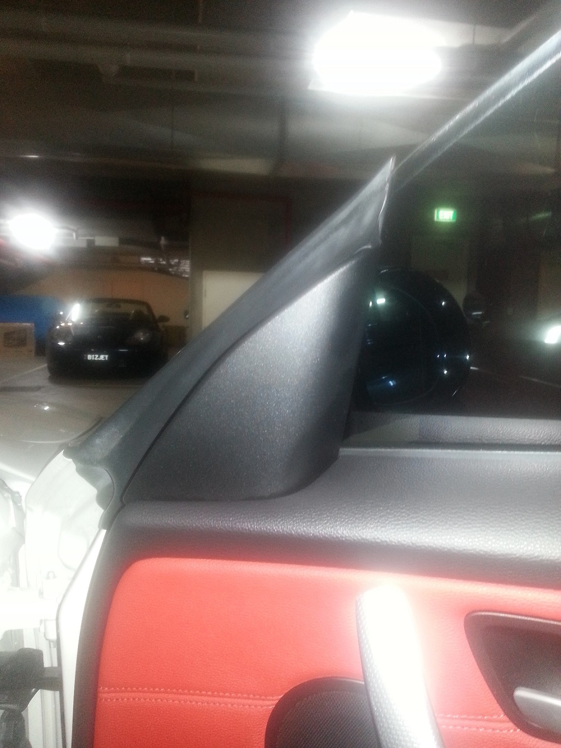

Pic 2 - this exposes 2 of the screws holding the mirror on to the door frame and the power and controls plug

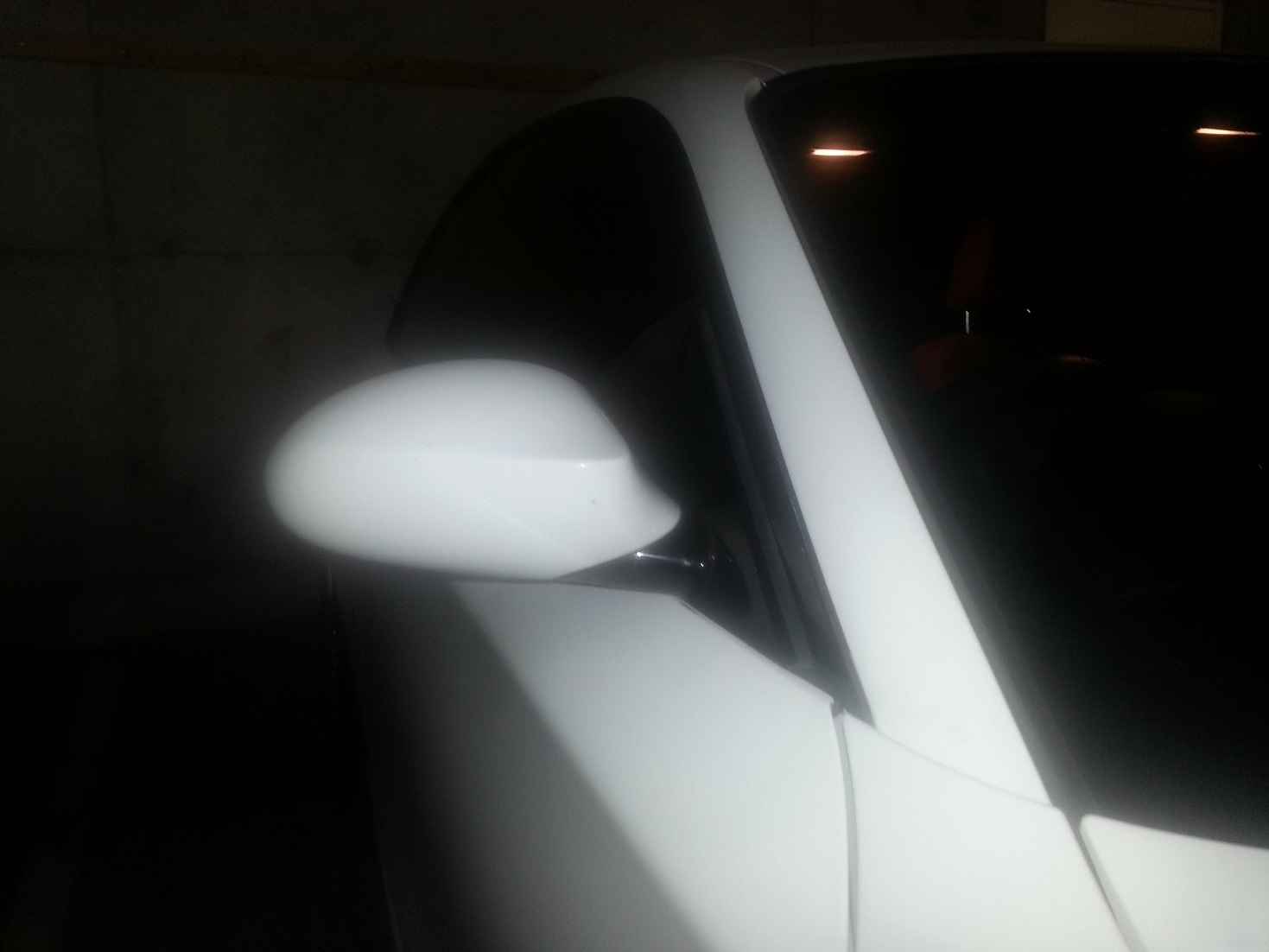

Pic 3 - location of the 3rd screw. unplug the connection by gently pulling on it and wiggling side to side. Undo the screws and gently remove the mirror by lifting the bottom edge and then pulling the mirror down from underneath the rubber seal.
Installation in reverse - ensure the mirror base plate goes under the rubber seal on top of the door, and that the rubber electrical socket lining is in good position in the opening of the door frame. Secure with screws, plug the connection back in and test it - you may need to start the car for the test or press the power button x2. Replace the triangular sail by wedging the bottom side of the triangle in the door trim and then sliding the top part of the sail along the window until the clips have locked it in place.

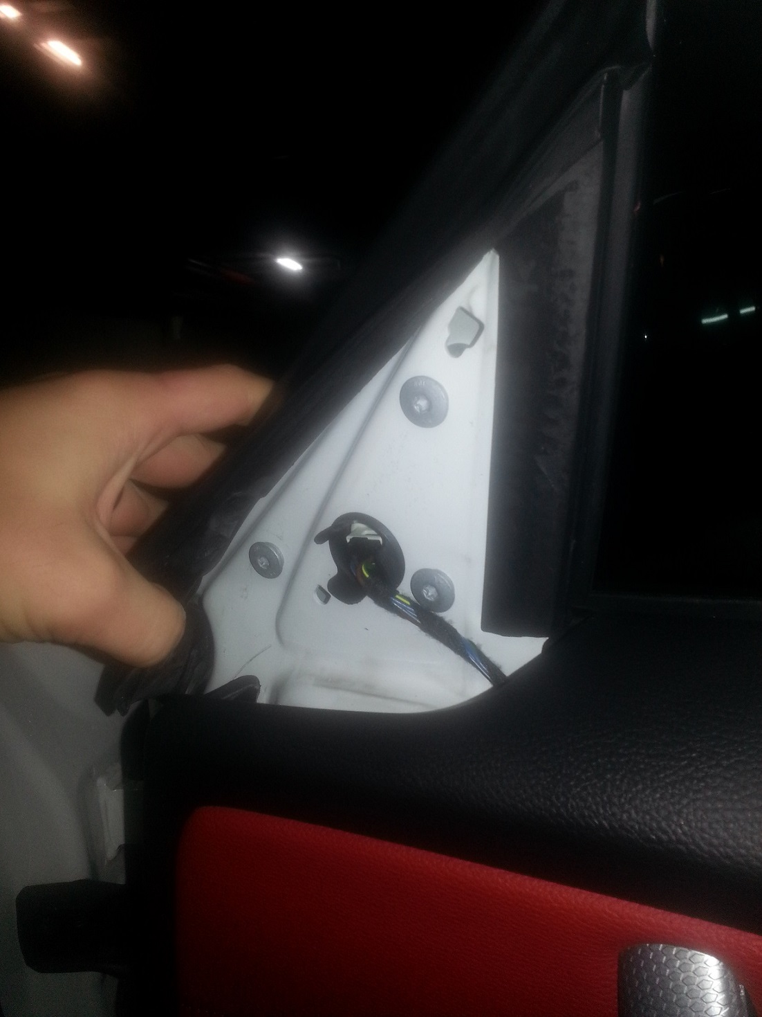

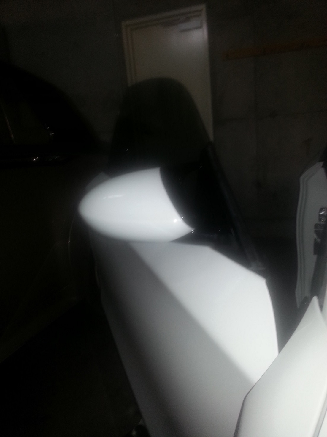

Pic 4 and 5 - before and after shot
