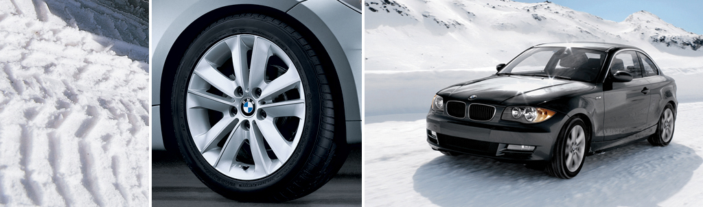

Winter tire size question for 135is
I'm in Denver. Sometimes we have a ton of snow on the ground, but it usually melts pretty quickly because of our sunny days. I need to put winter tires on the 135is, but doubt I will put more than 100-200 miles on it during our winter months.
If/when I do have the car out, it will be for short trips as a DD. The worst conditions will probably be more like wet/slushy roads than snow. As a matter of fact, I'm sure I'll be driving in dry conditions this winter as well.
But I'm having trouble choosing b/w the following sizes:
205/50 R17, 215/45 R17, or 225/45 R17
I'm going to buy a set of 4, so they'd all be the same. Thoughts on which size would be the best fit for my needs? Any advice is appreciated. Thanks!
For snow tires you want the most narrow, and tallest tire in order to apply the most pressure in the tire's contact patch. That is why BMW only offers(approves) of a 205/50 R17 mounted on a 7j x17 alloy wheel. That is what you want for winter performance.
Widder rubber will give you less PSI(pressure forcing down on your tires(not inflation tire pressure) and pressing the tires into the snow or ice. That will give your tires more "bite" and grip on snow and ice.

So what do the J stand for in 7j x 17?
Thanks for the reply. I see a lot of people running on 225/45 square and was wondering what the performance differences would be b/w the 205/50 and the 225/45. I guess what I'm asking is, why would someone run on 225/45R17s if BMW suggests otherwise? TIA.
Actually not quite correct. The only thing that will change the PSI on the road is the PSI in the tire (or the weight on the tire) Changing the size of the tire will not. It will only change the shape of the contact patch. Running 40 PSI in the tires will have the same size of contact patch if you are running a 205 or a 255.
