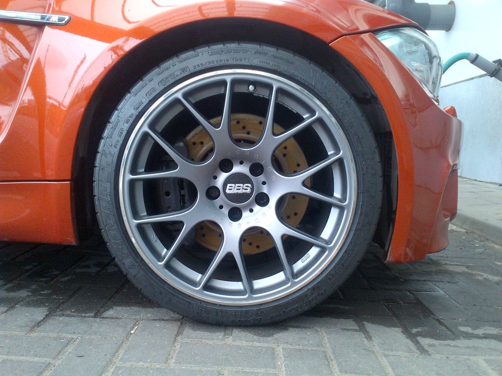

Earlier today got new Summer shoes for my BBS CH-R rims: PSS 255/35/19 + PSS 275/35/19.
Only minor rubbing at full lock to the left (maneuvering at parking speed).
Stock height (excluded to drop ride height, otherwise I destroy my front bumper on a nasty sidewalk curb I regularly need to negotiate, and which managed to already scrape some paint away from the underside).
Front (2.4 bar):
Rear (2.5 bar):
Back:
///M is art Artemis
Front (2.4 bar):
Attachment 997883
Attachment 997884
Rear (2.5 bar):
Attachment 997885
Attachment 997886
Back:
Attachment 997887
Attachment 997888
Looks good Artemis
