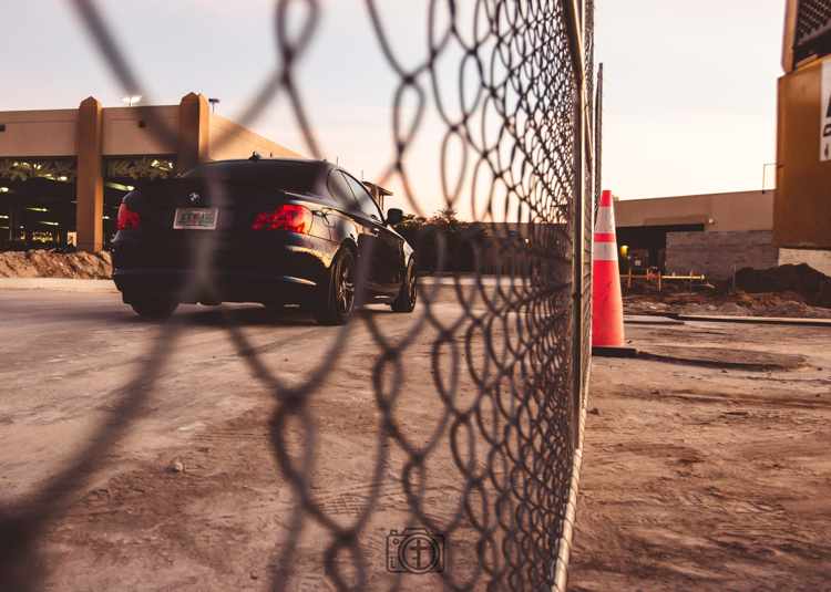

Here are some examples with then on
so sad they don't make these anymore

Someone should scan and print these.....please???
