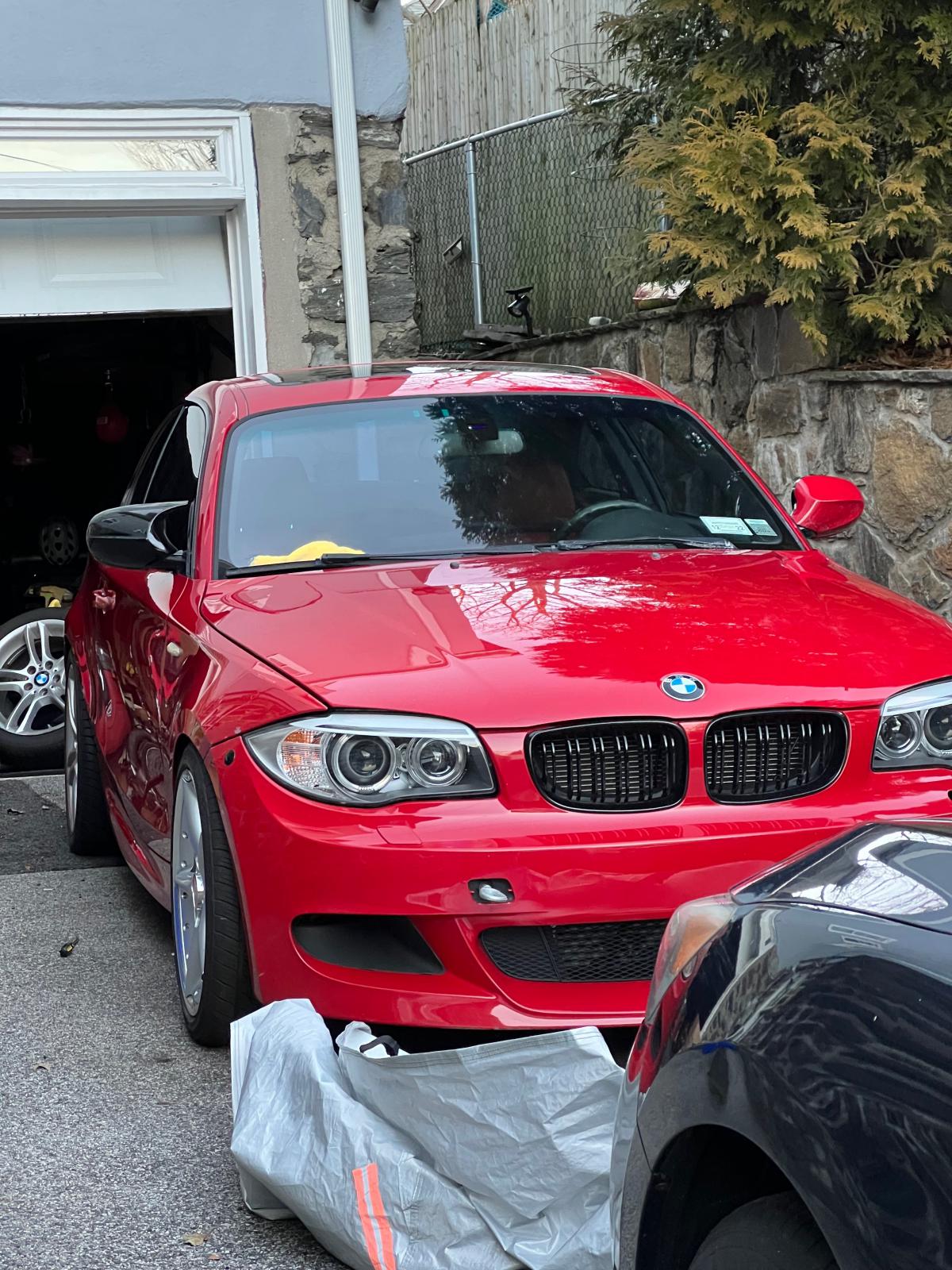

I used a quick release tab since finding a replacement bmw performance bumper is impossible. It isn’t the typical quick release that connect with a rubber band. The push in like a button and kind of look like a parking sensor. best I could do to save this bumper. But I would like to somehow fix the mounting points for added support and fix the gap I have between the bumper and fenders.
