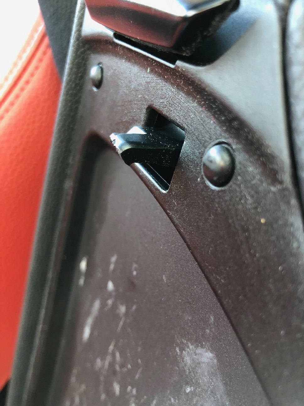

Armrest closing tab broke
Maybe it's the cold, but the armrest tab that locks the lid closed broke this morning. Can the tab be replaced by itself or do I need an entirely new lid ($126 at Tischer).

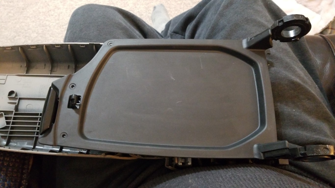

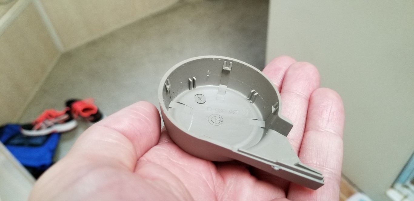

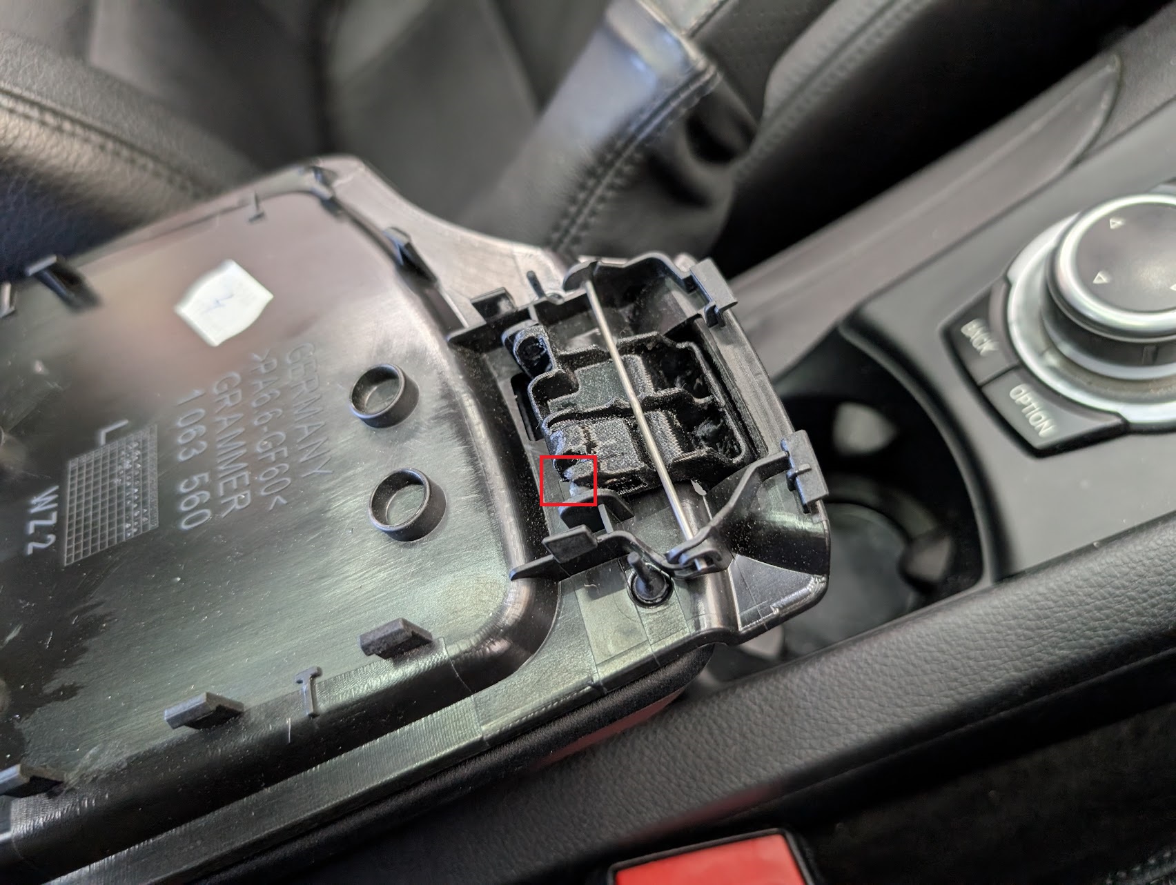

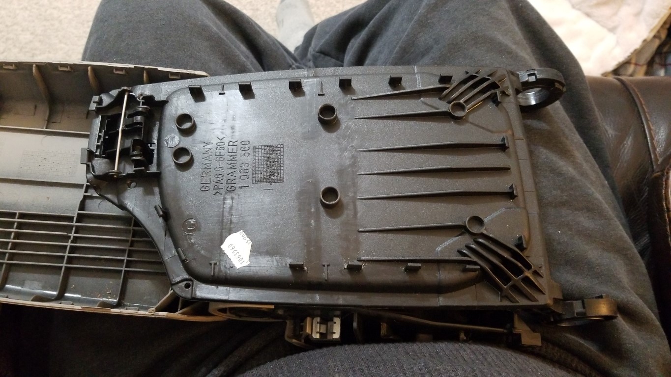

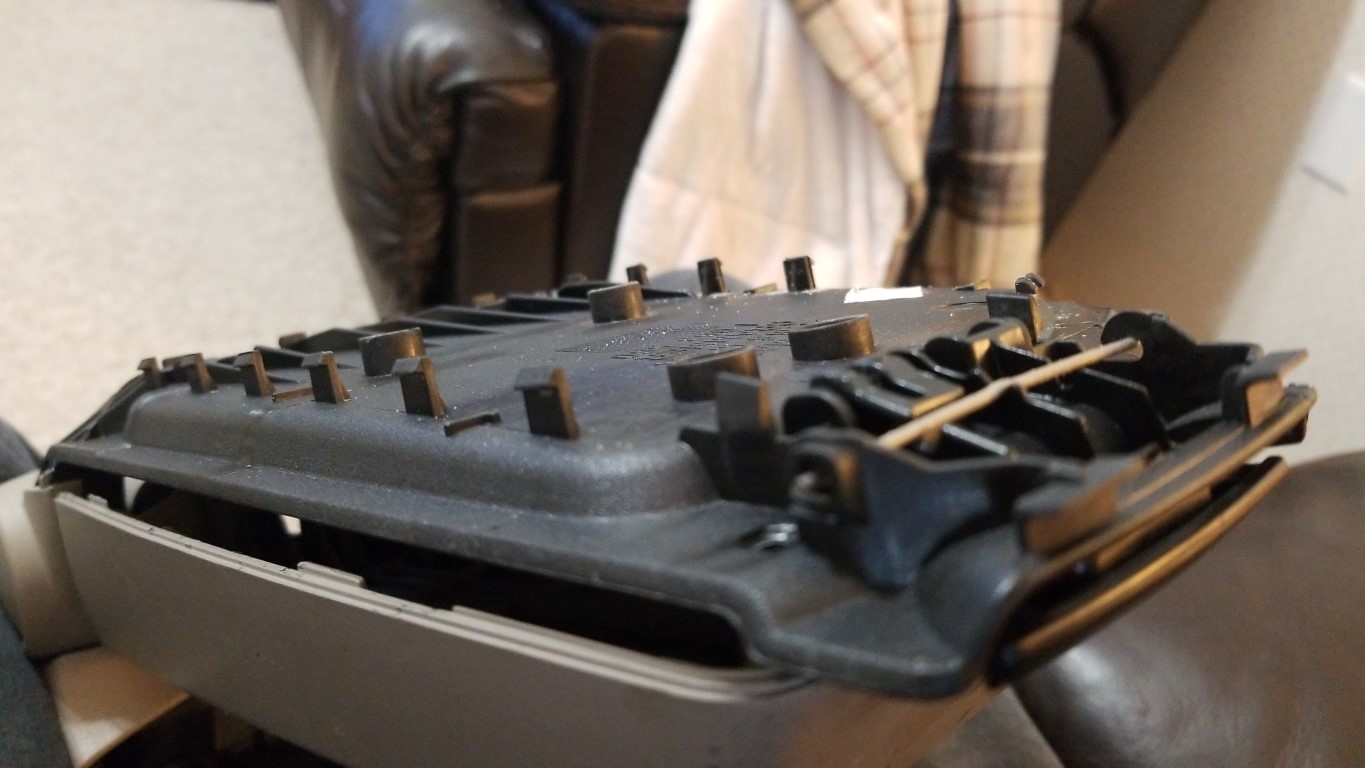

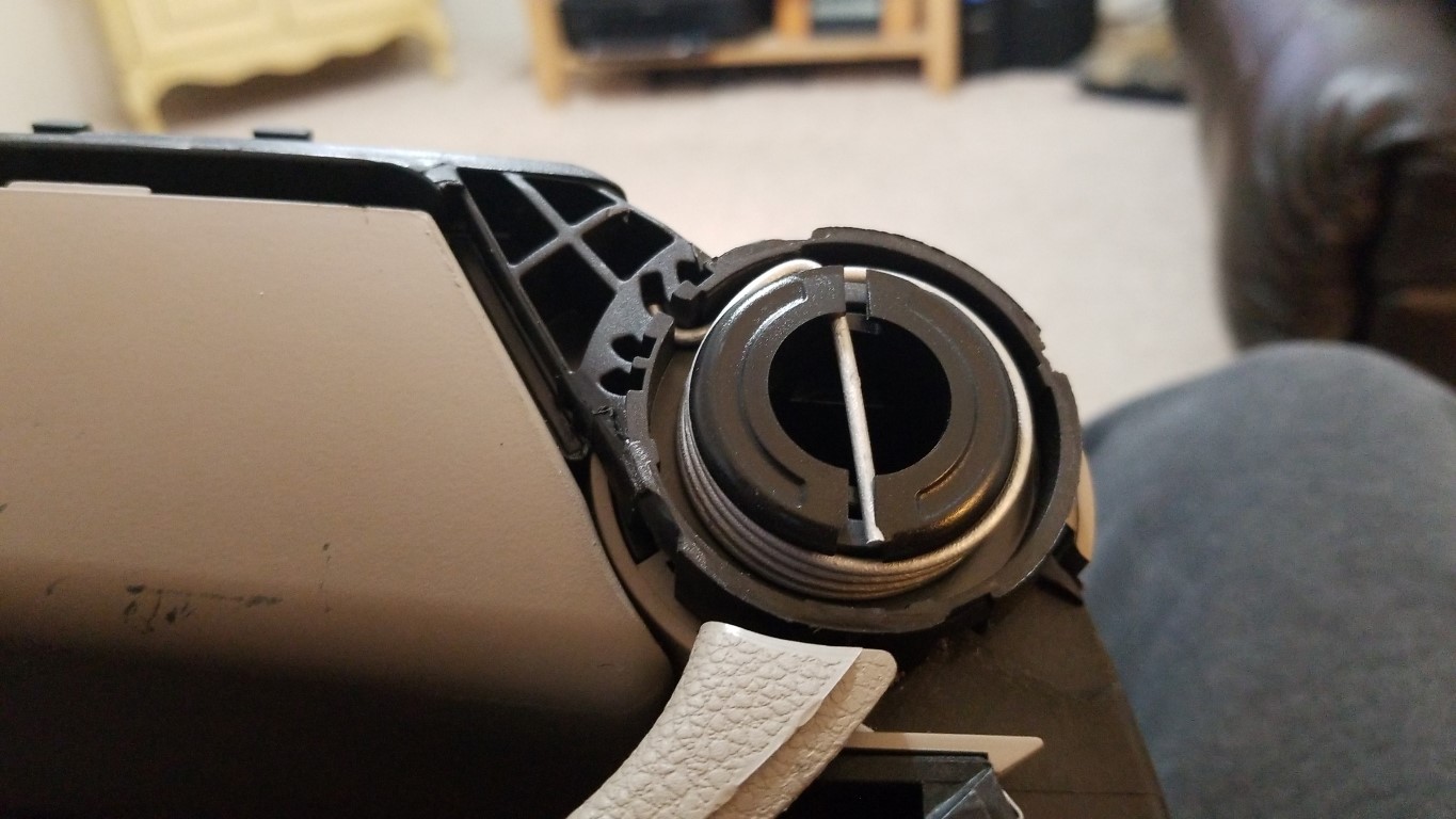

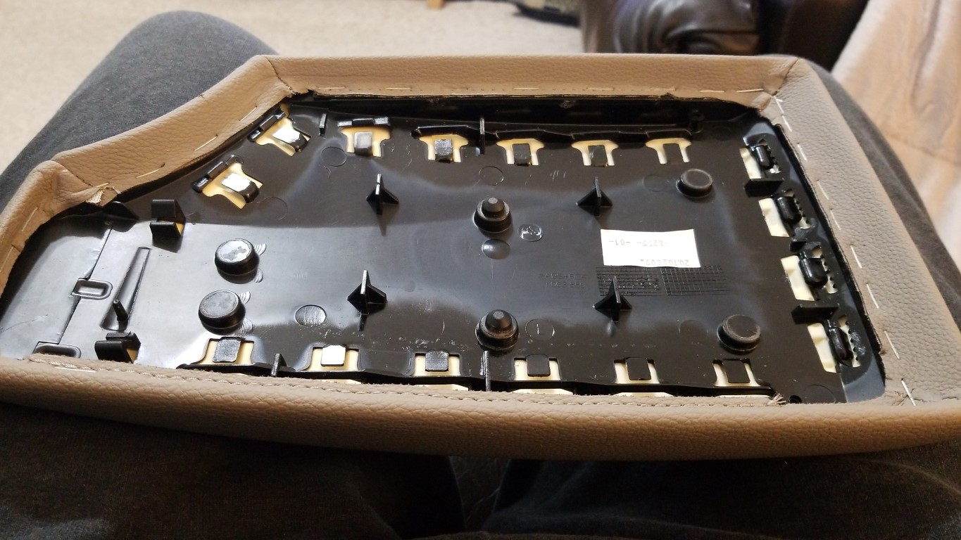

Allllll-Righty then.......
The armrest cover is held on with just short of a bazillion plastic tabs, but no screws. With a bit of attitude and perhaps a prayer the padded cover can be removed by grabbing from the rear and pulling up with some (way more than you'd think necessary) effort, working your way to the front.

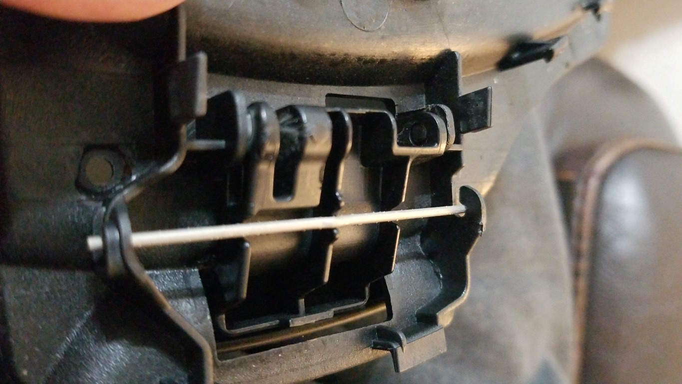

Once removed you get access to the latch mechanism. The latch can be removed & replaced, but there's no distinct part number for it. After playing with it for a few minutes I'd be happier leaving the latch in place and would be willing to ship you the whole inner lid, less cover so you can use yours, and not worry about breaking the latch mount points.
Happy to help, cost of shipping and a penny for my time. I'll check the classified rules, but, say...., $20 shipped? I may need to post in the classifieds with pics & such, I'll take a look at the rules to be sure, but otherwise shoot me a PM....
gtjosh20.50

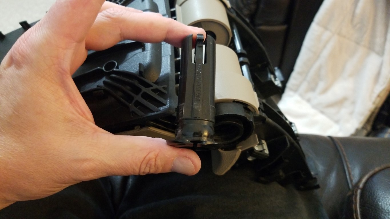

Oh, and I've got more pics- things like the hinge pivot assembly etc...
Just ask!

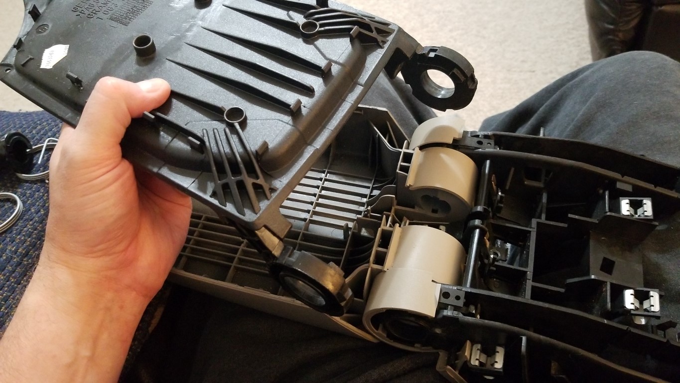

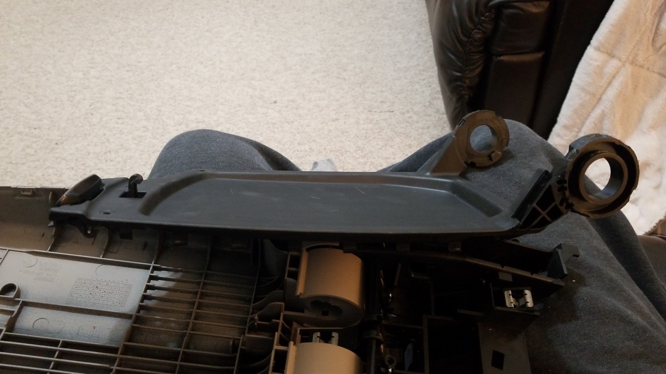

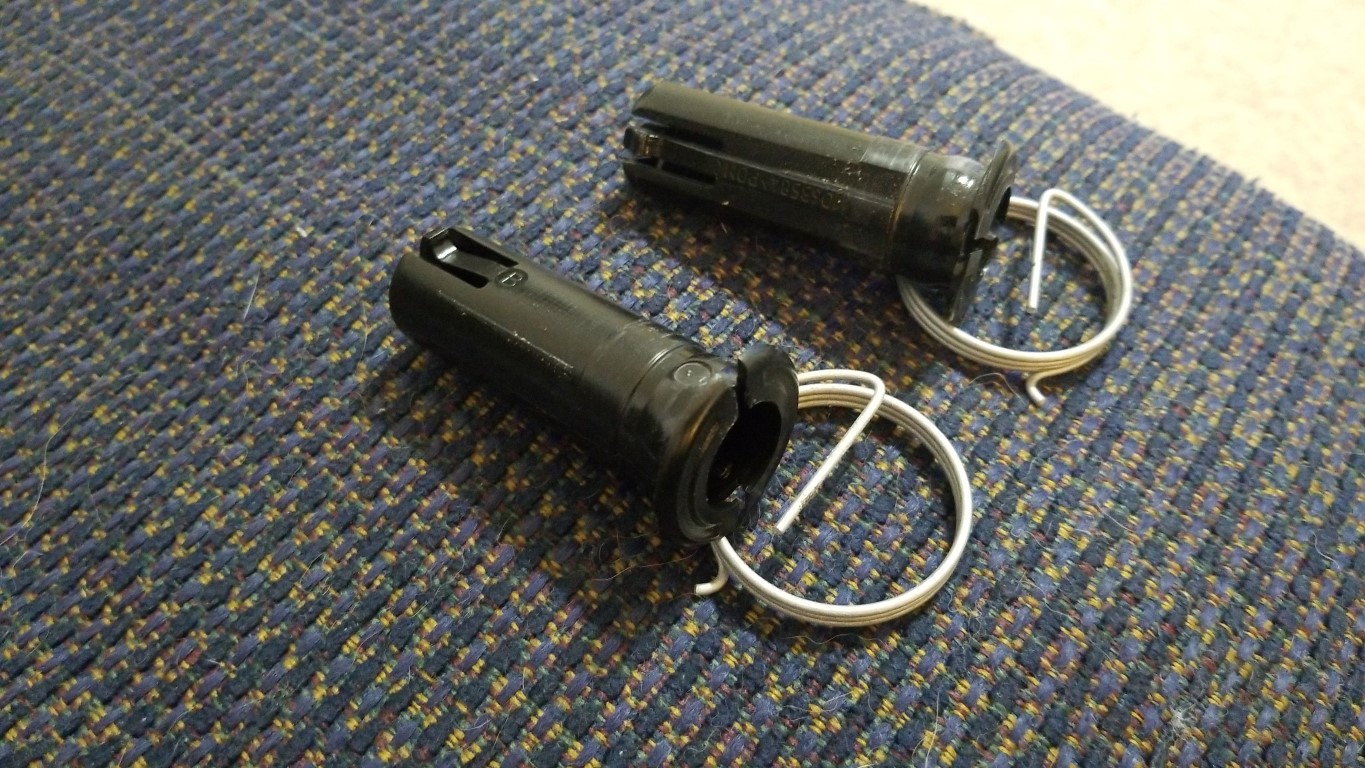

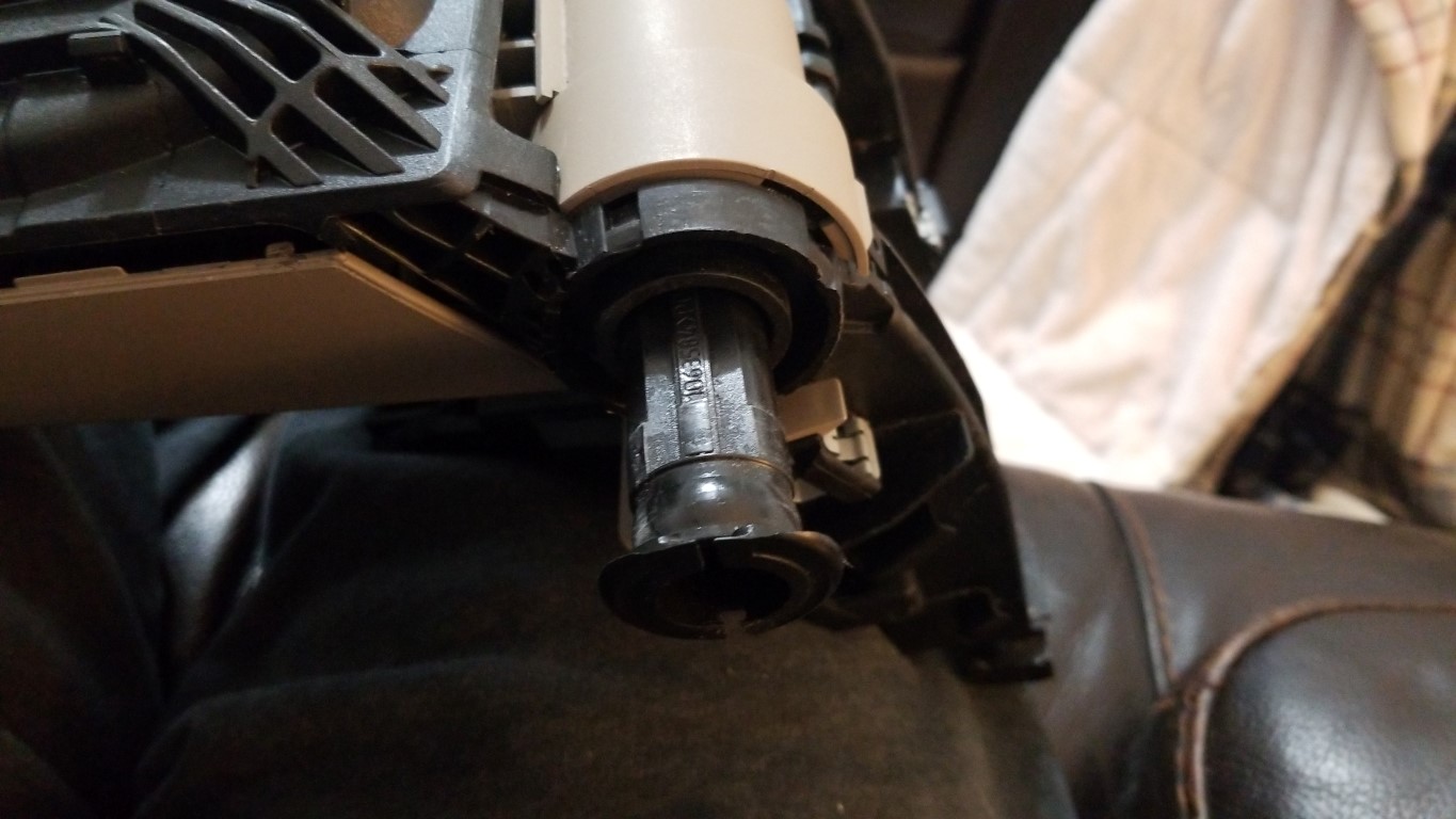

If it helps- tho you've probably already looked up the process...
-remove back cover- pretty much just grab & pull
-remove hinge side covers- little tiny tabs holding em on, they pop off easily
-remove springs- grab in center, twist just enough to pull out, hold tightly, they'll pop off when the end pops out of the notch
-pull out the pin the arm pivots on- give em a bit of a pry, just enough so that you can grab and pull them out
-then you can lift the lid right off- easy peasy

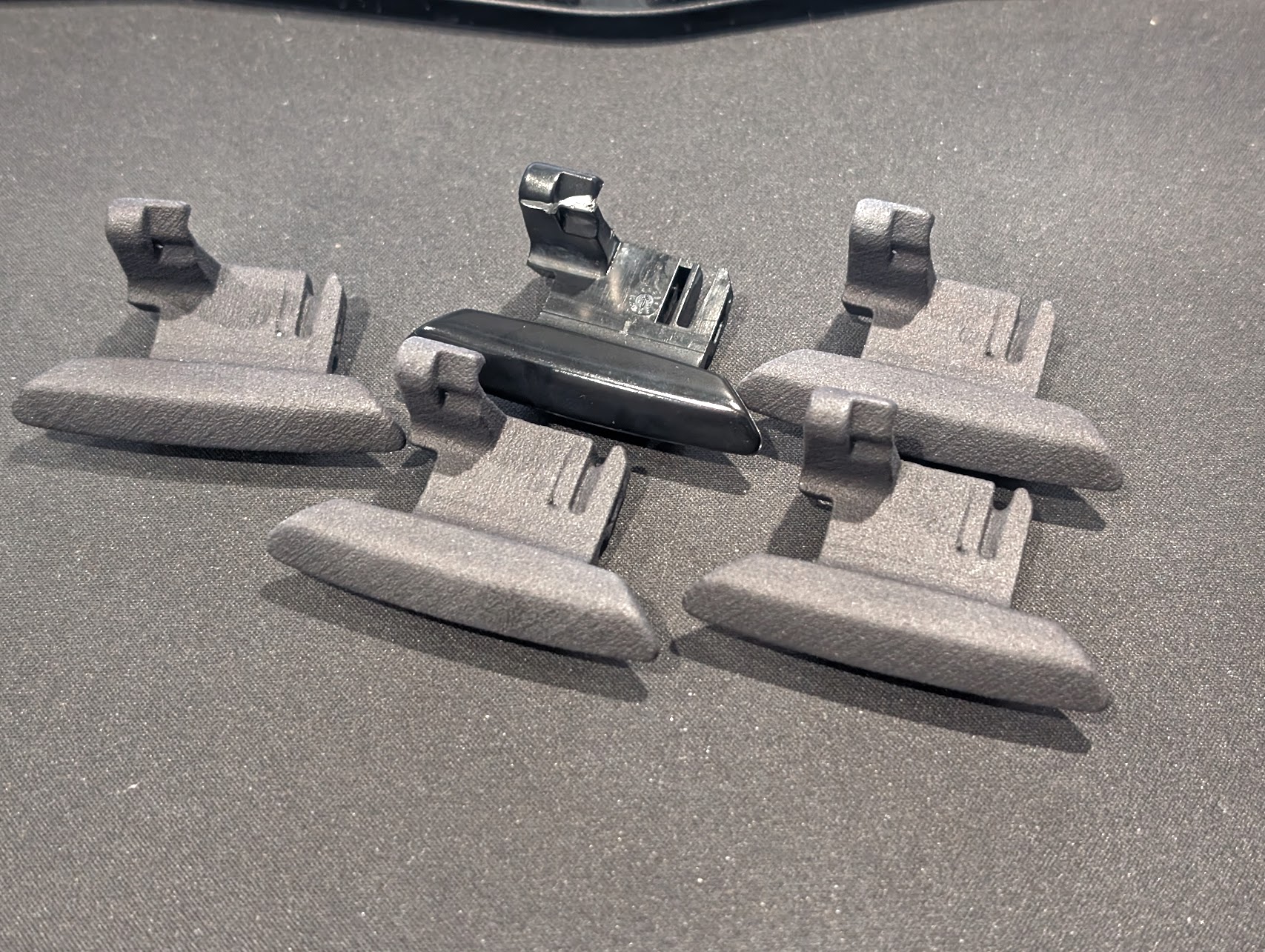

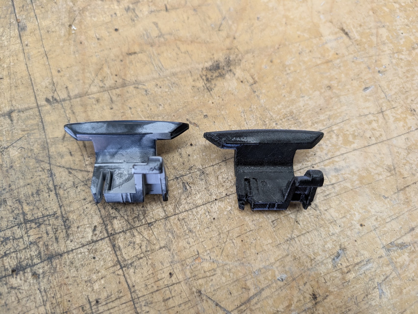

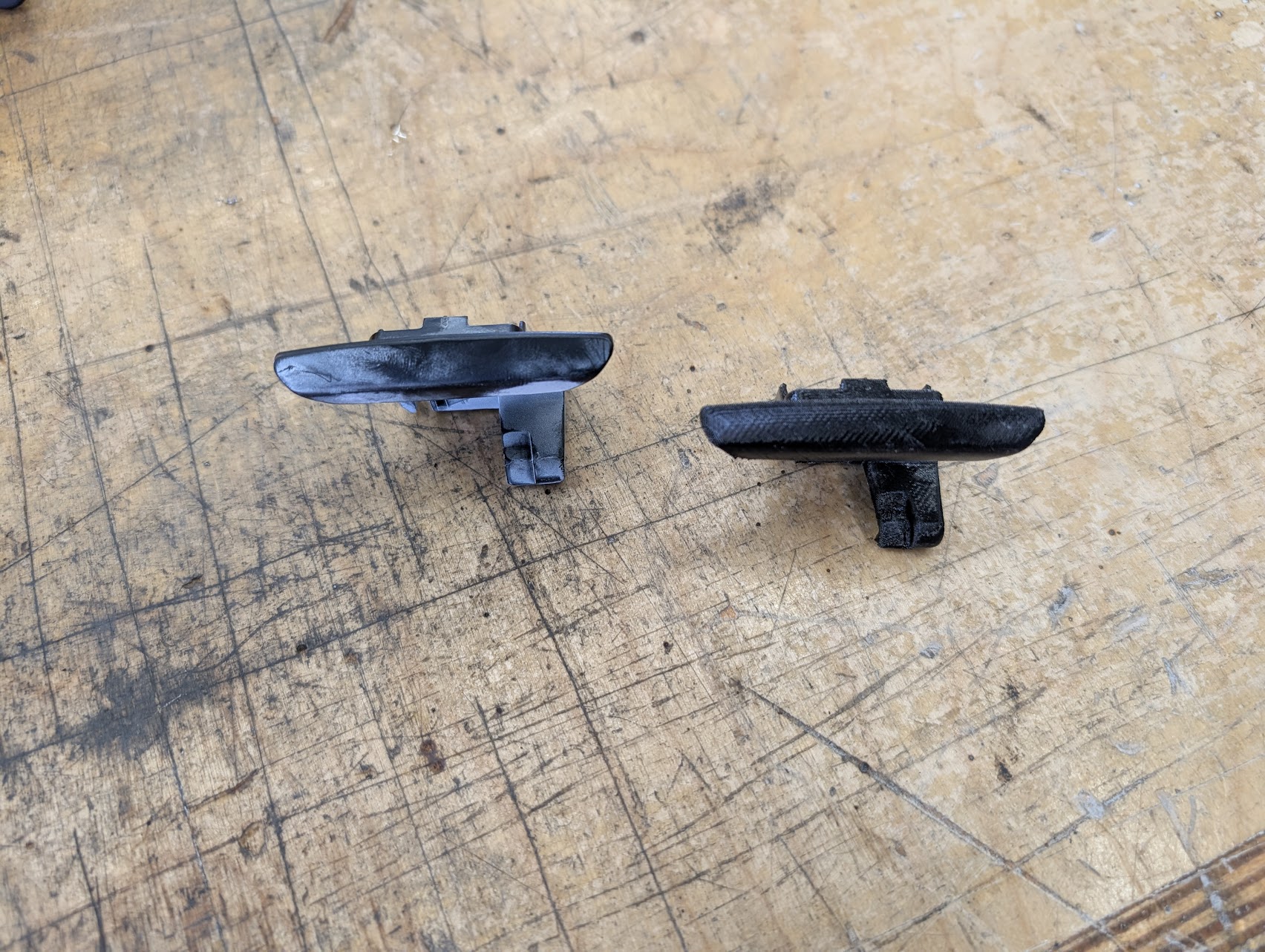

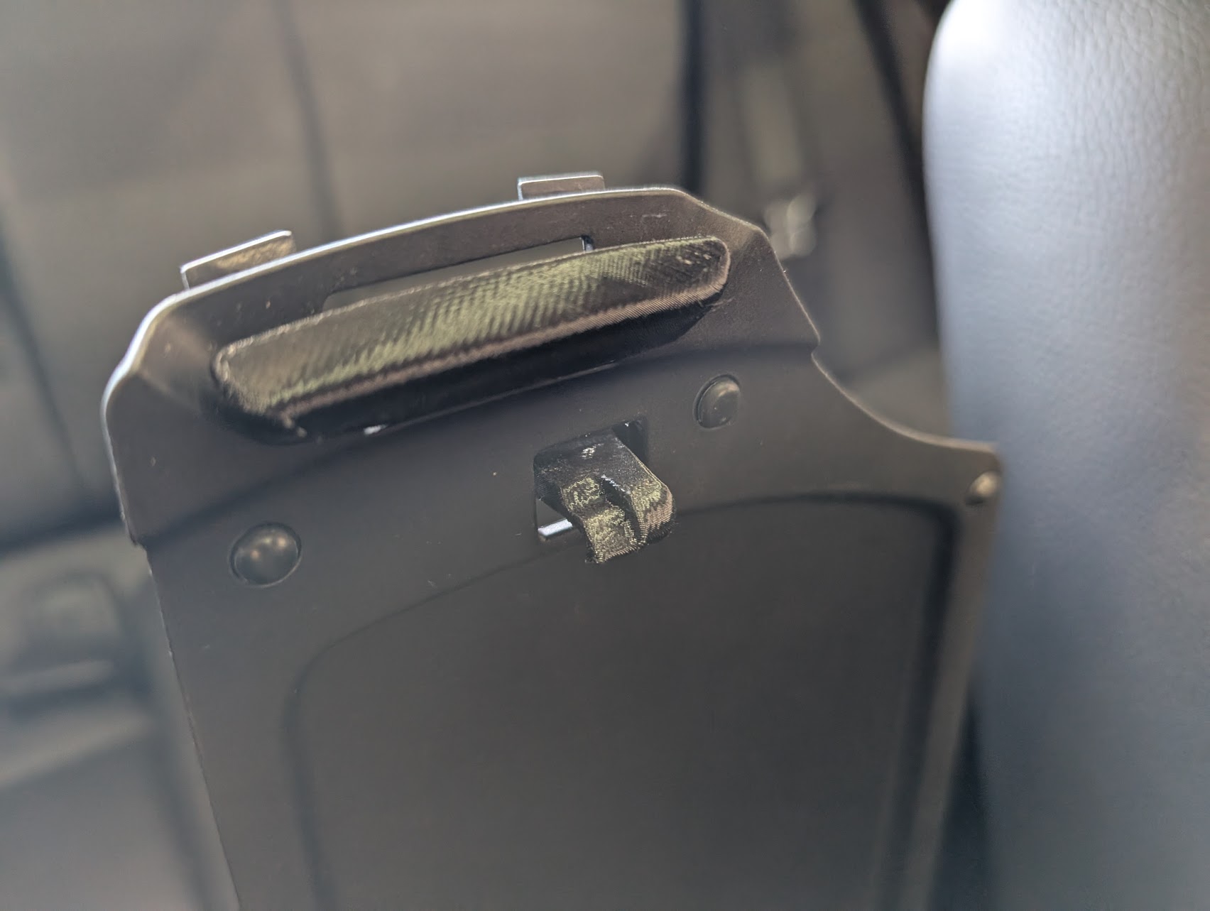

I'm digging this up from the grave because it's one of the top search results for 135i broken armrest tab. Why spend $160+ on a new armrest when I can use the 10X more expensive tools I already own to make it! Removed and 3d scanned the clip. The scan obviously isn't perfect and needs some touch up (I have no good knowledge on how to edit giant STL files. I use fusion and it's impossible in there.) Printed out of PETG on an FDM printer and as a proof of concept it works great. While cleaning up one of the holes I broke one of the pivot tabs (in red), but it's just the back side and it still functions. Trying a super fine layer height ASA print now. PCBway will SLS print it in black nylon for $5 ea for 2+. Hell, you could get it 3d printed in titanium for $338. That wouldn't break. LOL!! If you want the STL just hit me up. The original one is pretty big but I have a simplified one that I'm trying with this ASA print.
Like AvE says, do cool sht and put it on the internet.

That's the best part about 3d printing services. You can send in anything and they'll print it for you, usually in better quality / materials / and on nicer printers than normal people have.

Now to cast it in aluminum at home, super simple process.

Had an order from PCBway anyway. Turned out pretty good!

FYI, I had some more of these Nylon SLS printed and dyed black from a company in the US. Selling for $30 shipped in lower 48 states. Will still provide .stl file free of charge to active site members. We can see your join date and activity. Stop fishing.
