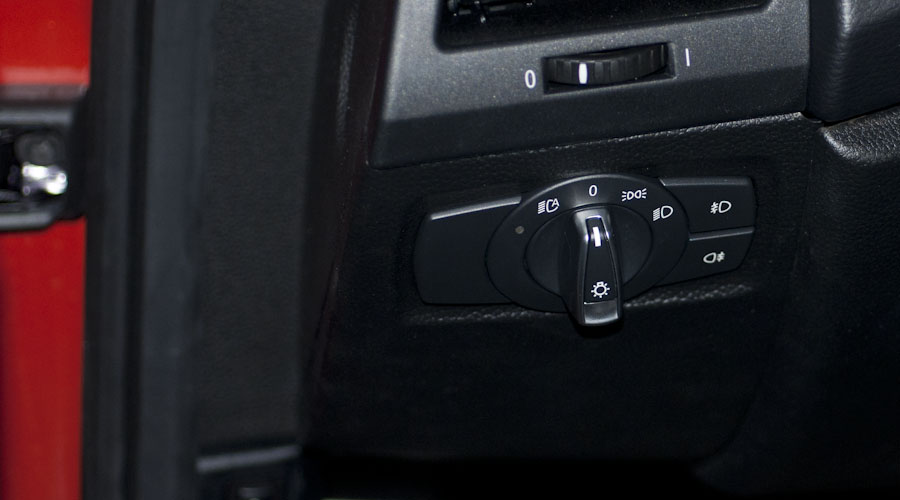

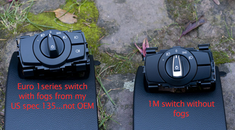

1M euro switch conversion

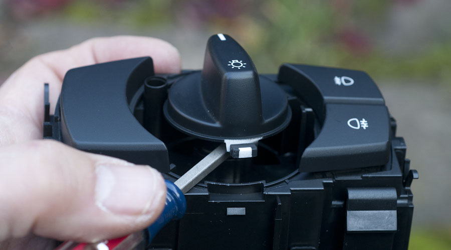

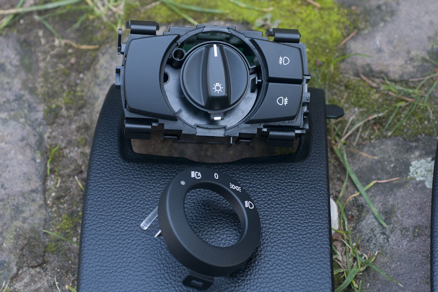

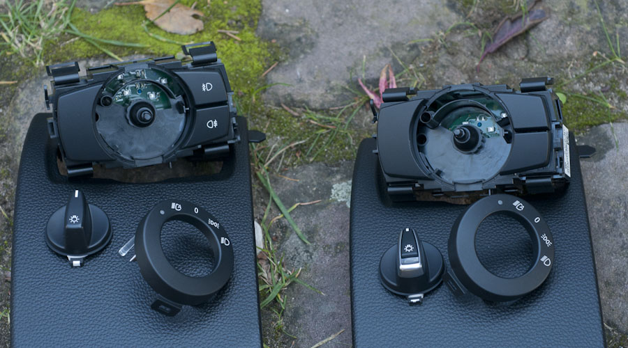

This is not a DIY on the entire euro light switch replacement which AndyM did an excellent job at on:
http://www.1addicts.com/forums/showthread.php?t=209558

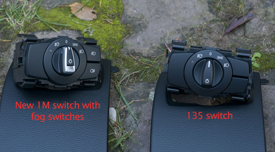

Rather, this is taking a euro switch that i bought for my US SPec 135 and seeing if it works on a US Spec 1M and then swapping the light switch between the two units...
The long and short of it...yes it works. So if you also wanted to keep the chromed knob, you have to disassemble the switch unit like in the following photos.

Remember...you already have the fog switch built in, you just can't access it because the little plastic Tangshan are preventing you from depressing the switch...

I think this is the part number for the euro fog light switch: #61319169400
Remember you have to select EUROPEAN build at the start of RealOEM to find EU parts.
http://www.realoem.com/bmw/showparts...93&hg=61&fg=35
